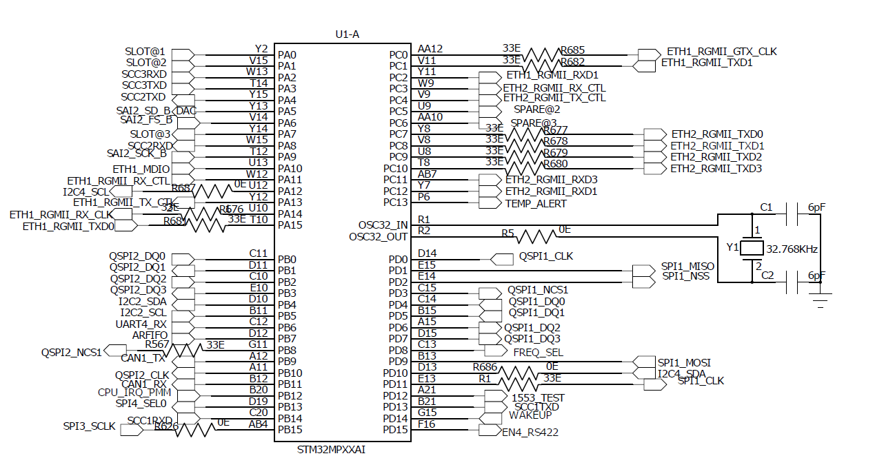

    I am noticing some things in the schematic as well:
    1. you have a 4.7K RBIAS resistor to GND, however this should be 11K. Please change this to the correct value:
    2. DP83869 integrates termination resistors on the RX lines of the RGMII. You have external termination resistors on these lines as well, however I'd like to see if replacing the external resistors with 0-ohm resistors has any effect. This would avoid any possibility of double termination, which could slow rise/fall times by increasing the impedance on the line:

    1. RBIAS Resistor Modification
      • Changed the RBIAS resistor value from 4.7 kΩ to 11 kΩ as recommended.
      • No improvement was observed in the 10/100 Mbps issue.
    2. RGMII Series Resistors
      • Changed all series resistors on the RGMII interface to 0 Ω.
      • The issue still persists.

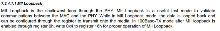

    1. There is a TX_SFD signal that can be configured on the PHY to show when a packet is transmitted on the MDI. This signal corresponds to the first symbol after the packet preamble (called the SFD) and will go high when this is transmitted on the MDI.
    2. An MII loopback test will take data from the MAC interface and transmit this back towards the MAC (MAC --> PHY --> MAC). This is configured by setting bit 14 in register 0x0000

  • Hi Babu,
    In 100M mode you should also set register 0x0016 to 0x0004 as noted in the datasheet:
    Shane

  • Hi Babu,
    On my EVM I tested 100M loopback by setting the following:
    Register 0x0000 = 0x5140
    Register 0x0016 = 0x0004
    With this configuration I saw both the TX and RX pins on the EVM toggling.
    For 1G and 10M I don't see a requirement to write register 0x0016, so in these modes it should be sufficient to write 0x0000 = 0x5140. I did not disable autonegotiation in my test and I did not have anything plugged into the RJ-45 port.
