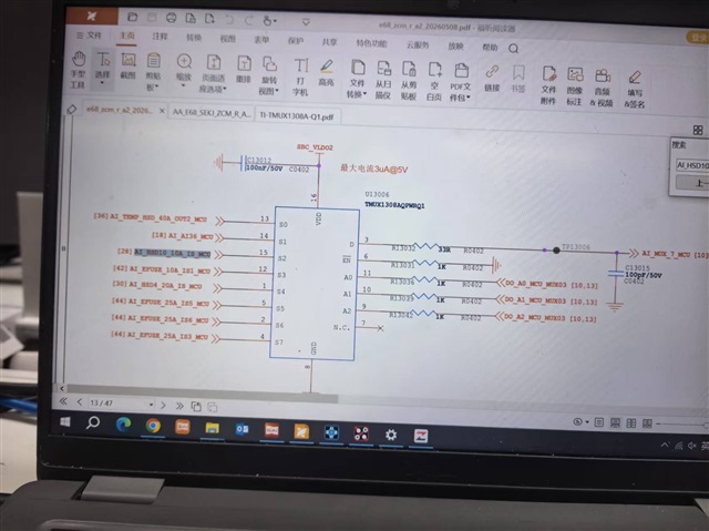

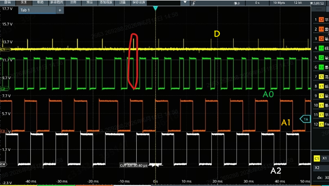

My customers found that there is an around 0.6V spike at the D pin ouptut of TMUX1308A-Q1 during the changes of A0/A1/A2, while this was not happening each time the A0-A2 pin changes. Waveform as below.

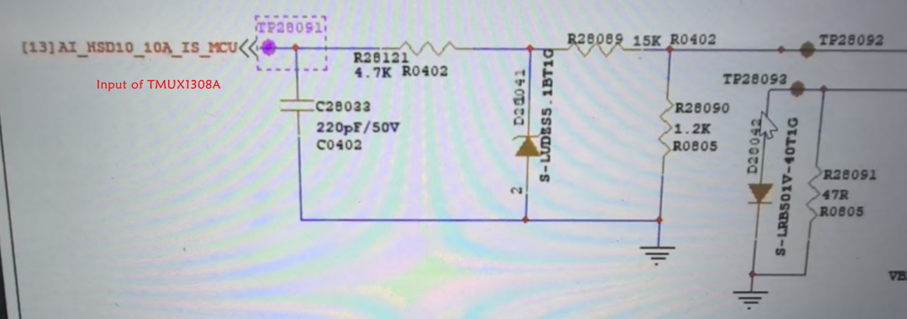

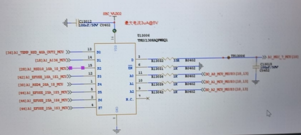

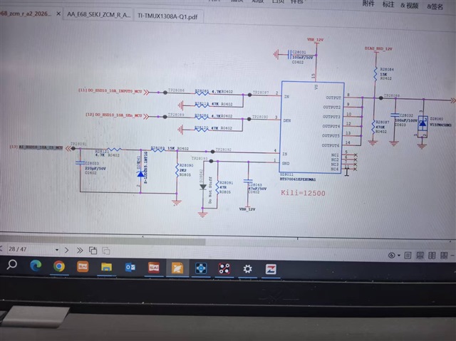

What could be the reason of such spike? I think might because of the signal coupling from the A0-A2 to the output/inputs. Pls help check  the schematics as well and give some suggestions on this, thanks.
