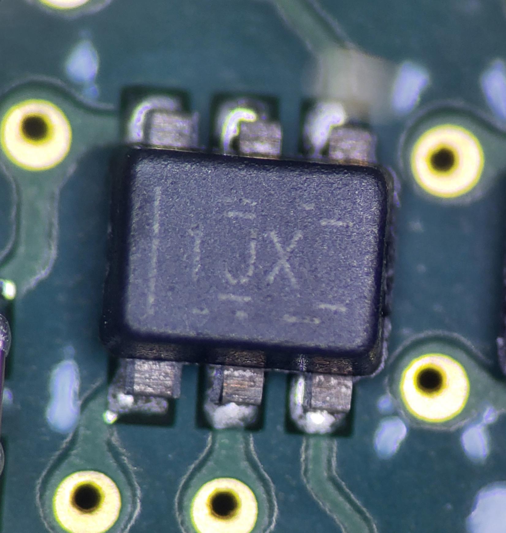

CST ADVISE THAT THE PART IS DEFECTIVE. SEE BELOW NOTE FROM CST "Reference
the attached images, there is plastic around the solderable surfaces of
the leads. The parts are not alligning or wetting to the landing pads. PIC 1.jpgPIC 2.jpgPIC 3.jpgMOUSER_Invoice_88623779.pdf s are not aligning or wetting to the PCB lands."
