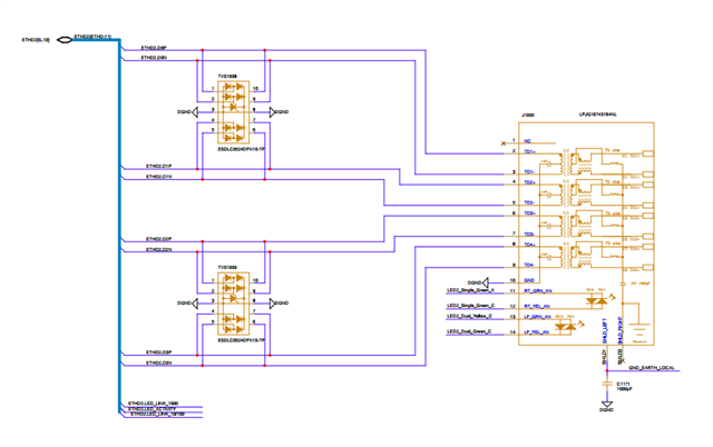

EMI Test Failing Class B by 10dB @ 125MHz when linked using 1000Base-T.
Product is a plastic case, using AM6412 RGMII interface.
Bob Smith temination "chassis GND" connected to Main board digital GND via 1nF 2KV capacitor.
Integrated magnetics used, PHY side includes 4 separate center-tap capacitors for each winding.
