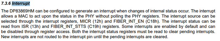

  • About the INT_N pin, I found why it is stucked at 0
    I have a bug in my driver, it does not read FX_INT_STS @ 0xC19, and it does not read INTERRUPT_STATUS @ 0x13, explaining 2 issues:
    - FX_INT_STS was not 0 when reading it manually (because the driver did never read it)
    - INT_N does not goes back to 1 after a manual read of FX_INT_STS (because it is also associated to INTERRUPT_STATUS)
    Writing 0 to INTERRUPT_MASK and reading FX_INT_STS  when the INT_N fall to 0 make the interrupt scheme working normally.
    According to my understanding, INTERRUPT_STATUS is only reporting things about ETH. In fiber mode, it does not give any more useful information than FX_INT_STS and can be masked/ignored. Do you confirm?
  • Hi Nicolas,
    As noted in the datasheet, both interrupt registers must be read to clear pending interrupts:
    If you don't need any interrupts from the INTERRUPT_STATUS register you can disable these interrupts via masking, however the register may still need to be read to clear an active interrupt.
    For the power network it seems like the DC/DC is generating noise on the power line that interferes with the devices on your board. Improving the power decoupling/damping network or swapping to a less noisy source would be my recommendation
    Shane

    The interrupt handling function is only reading one register (INTERRUPT_STATUS).  FX_INT_STS is symply ignored. This tends to suggest that the driver has not been tested in fiber mode.
  • Hi Nicolas,
    Our current PHY drivers can be found at this link: https://github.com/TexasInstruments/ti-ethernet-software/blob/main/linux_drivers/dp83869.c
    I'll check with my team to see if interrupts are handled appropriately in fiber mode through the driver.
    Shane
  • The feedback I'm getting is that the driver does not check for fiber interrupts, and it seems like you are able to see this as well. The 0x13 interrupt status register should be read through the driver, though let me know if this is not working.
    Shane
  • We modified dp83869_handle_interrupt() to read both IRQ regs (0x13 + 0xC19). Now all IRQ flags are cleared, the nINT line goes back to 1 and things are working as expected.
