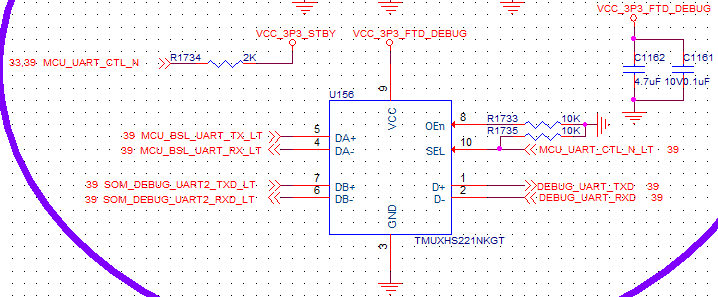

Hi Team,
We are planing to use TMUXHS221NKGT part in our design for switching between two UART interfaces (refer to the image)
could you confirm whether TMUXHS221 can used for UART application as the datasheet is mostly focused on USB2.0
