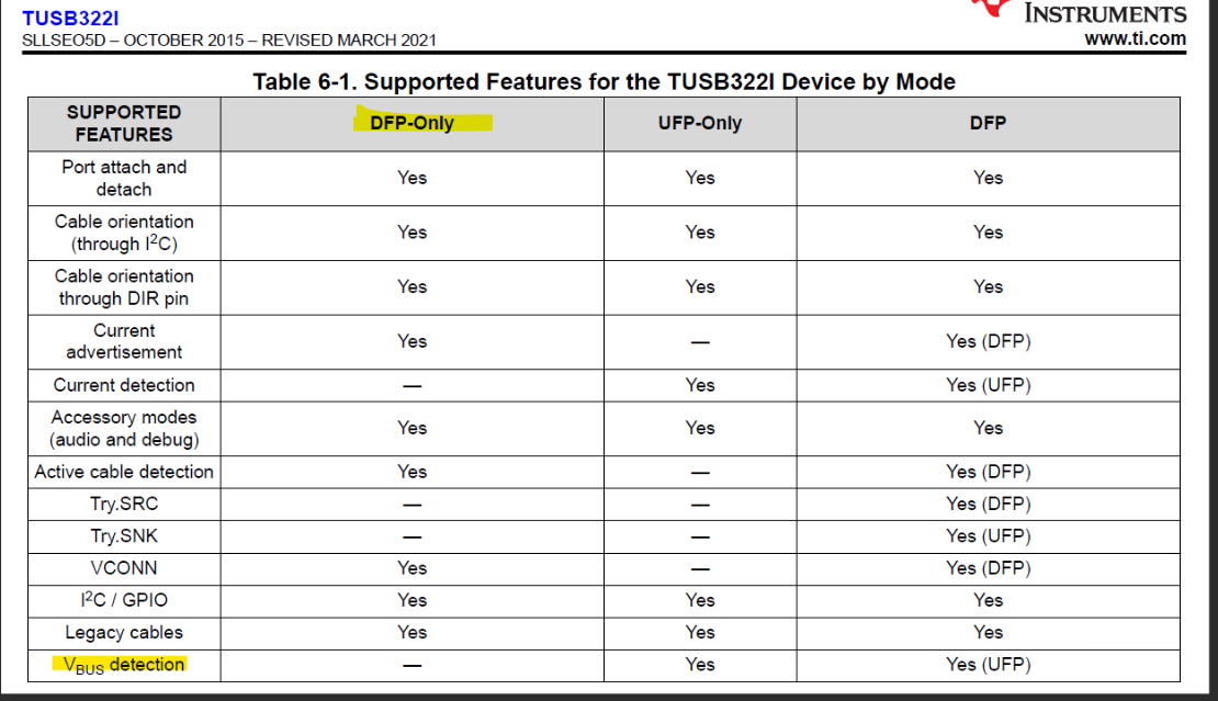

TUSB322I: DPF mode only, Does pin "VBUS_DET" still need to be connected to 900Kohm?
Part Number: TUSB322I
Other Parts Discussed in Thread: TUSB542
In terms of application, the USB-C port (Host only) on the board is only used to connect external USB devices. Does pin "VBUS_DET" still need to be connected to 900Kohm?
NOTE:  We use TUSB542 + TUSB322I.
  • Hi Sophie,
    If only DFP mode is being used, this 900KOhm resistor is not required. The VBUS_DET pin can be left floating.
    If any other mode could potentially be used, this resistor should be left.
    Ryan
