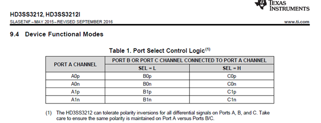

  • Hi Ryan,
    According to the datasheets for TUSB321AI and HD3SS3212I, please answer the following questions:
    Q1: When connecting CC1 & CC2 of TUSB321AI to a USB-C connector, is swapping always necessary?
    Q2: In Figure 3 of the TUSB321AI datasheet, why is the polarity of the SS signal reversed for CxP and CxN connected to the HD3SS3212 in the USB-C connector? (Because BxP and BxN in the figure do not have PN reversal.)
    Q3:  Is pin 11 "DIR" of the TUSB321AI defined as follows:
    DIR = H: When a voltage level change is detected on pin 2 "CC2"
    DIR = L: When a voltage level change is detected on pin 1 "CC1"
    Sophie
  • Hi Sophie,
    For specifically with the HD3SS3212, CC1/CC2 are swapped to minimize the crossing of the SS signals:
    For ease of routing, to ensure the signal does not need to be crossed. USB3 supports polarity swapping, so there is no issue with swapping P/N.
    Correct.
    Ryan
