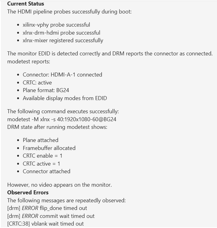

We are using HDMI redriver TMDS1204RNQR in our Versal (XCVE2302-1LSISFVA784) based design.The HDMI display pipeline initializes successfully, the monitor is detected via EDID, and the DRM pipeline is configured without errors. However, no video is transmitted to the monitor.I'm sharing the schematics. please let us know what could be the issue.HDMI2.pdf

    For register 0x09, can you please write 0x06 to it? This will force TMDS1204 to be always in active state.
    For register 0x0A, why do you enable lane swap (bit 7) and disable DDC snooping?
    I don't see register 0x20 or 0x31 being set, are you sending any HDMI2.0 or HDMI2.1 video resolution?
