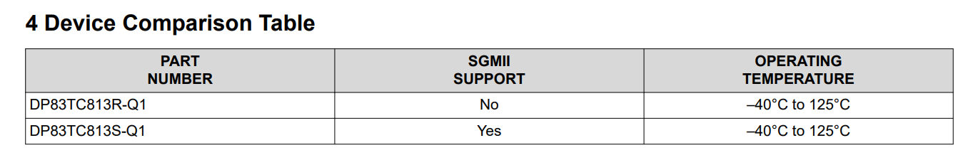

Hi team,
Is DP83TC813S p2p with DP83TC813R if I don't use RGMII interface?
  • Hi Gary,
    The only difference between DP83TC813-S and -R version is the SGMII support. -S and -R variants are P2P compatible with the exception of SGMII support.
    • DP83TC813-S supports SGMII, RGMII, RMII, and MII.
    • DP83TC813-R supports RGMII, RMII, and MII.
