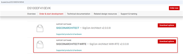

3. Could you please confirm if the TI SigCon GUI supports Windows 11? If so, please provide the download link or the necessary installation files.
Please note that I do not have any National Instruments (NI) software currently installed.                Please calrify  for the installation package includeing the NI environment what is the total estimated disk space required for the complete installation?

    3. TI SigCon GUI supports windows 11. You can download the SigCon version with RTE without needing to separately install NI software. Estimated disk space is ~50MB.
