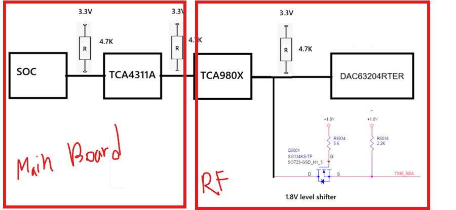

Hi team,
I notice that we don't recommend adding any pull-up at the B-side of TCA9803 in other thread
https://e2e.ti.com/support/interface-group/interface/f/interface-forum/1602358/tca9517a-i2c-interface-lower-voltage-level-support-requirement
Since the customer has a trace to connect between main board & RF board, they required the buffer on both side, and wondernig if the pull-up on the TCA4311A side will affect the TCA9803's B-side or not
Roger
