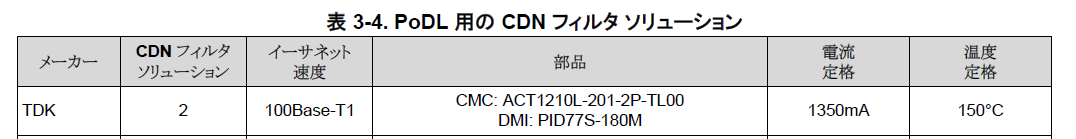

For TIDA-020060, the documentation specifies the use of the TDK inductor PID77S-180M (current rating: 1350 mA) to support 50 W PoDL PSE output.
However, the PID77S-180M is currently an obsolete part number.
Please provide the manufacturer and part number for a suitable alternative inductor that is guaranteed to operate correctly.

  • Hi Yannik Muendler,
    I was unable to find the PID77S-180M on TDK's website.
    To be precise, the only models I could locate were the PID77S-251M, PID77S-560M, and PID77S-650M; however, all of these have low rated current values, so I do not believe they can support PoDL Class 9.
    Consequently, I have inquired about suitable alternatives.
