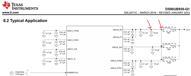

      1. A power supply called "POC_DIAG" is measuring much lower voltage than expected (about 0.552V than the expected 1.2V).
    5. The UB936 power rails were probed and there were no abnormal voltages at the UB936 power pins.
    Follow-Up Questions:
    1. Where is "POC_DIAG" measured at? Is it a voltage rail on the deserializer or the serializer?
      1. Is this perhaps some type of "power good" signal outputted by a PMIC or power IC?
    2. Just to double-check, when you probed the UB936 power rails, did you probe at the decoupling capacitors near the IC power pins? Or the side of the ferrite bead facing the IC power pins?
