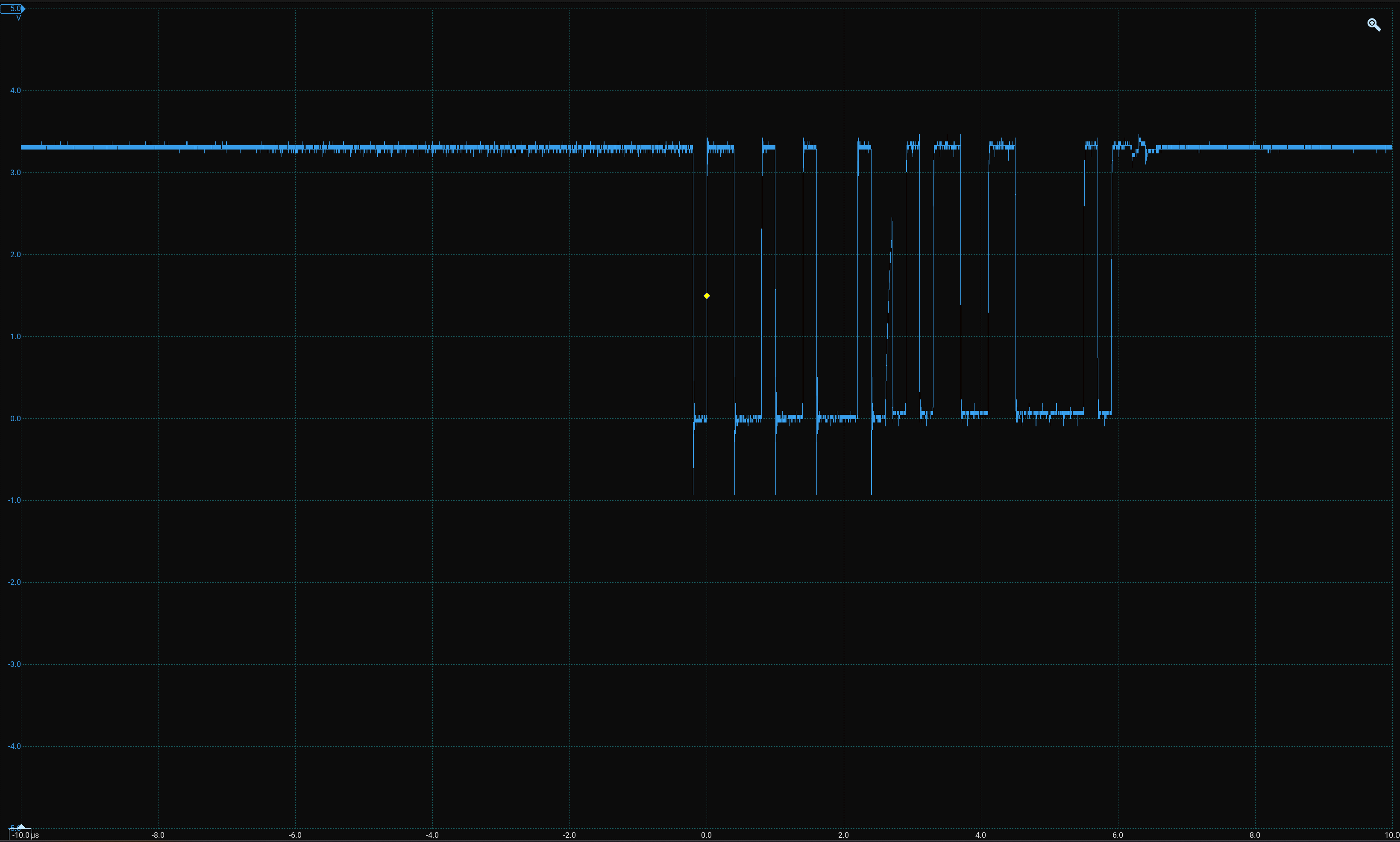

I'm having trouble bringing up a custom board using the DP83867, no matter what register I read from over MDIO the PHY always responds with 0xB305.
Any suggestions what might cause this?
Oscilloscope trace:

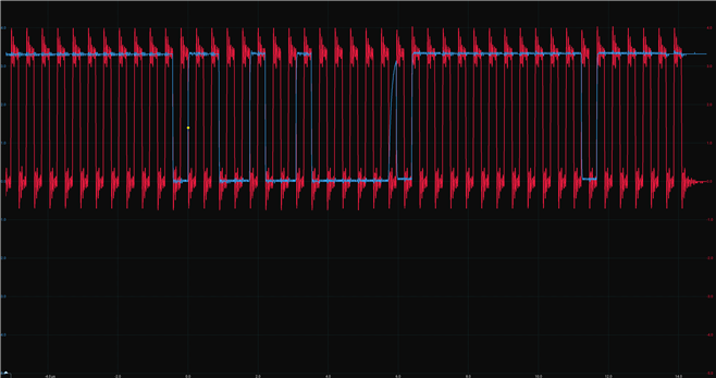

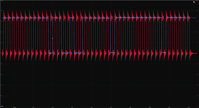

    The PHY including MDIO is connected to an FPGA and I'm using a VIO core to set MDIO register addresses and values to be written, I previously had a very similar setup working with the DP83867ERGZ-S-EVM so I suspect now the issue is somewhere in my hardware design.
    Looking at the MDIO signals on an oscilloscope and decoding commands by hand they look correct to me so I think it's unlikely the command is the problem. Below are oscilloscope screenshots (MDIO in blue MDC in red) of read transactions from address 0x00 and 0x1F giving the same response. These are using a different PHY to my original post but with identical configuration and the response is different to what I was getting before but still always the same.

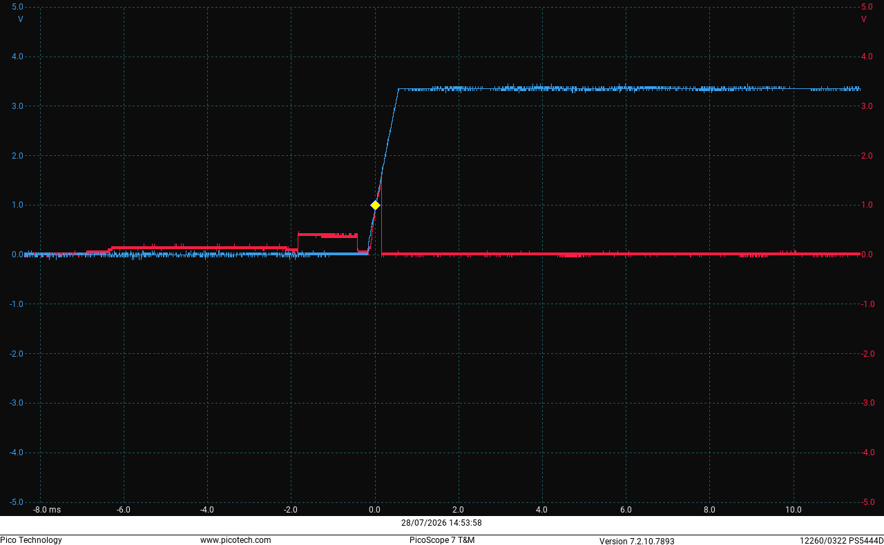

    Here's a few waveforms of various pins relative to VDDIO (blue) during power up. I foolishly didn't connect the reset to something I can drive programmatically so will have to find a way to do that and get back to you.
    RESET_N
    PWDN
    VDD1P0
    VDDA1P8
    VDDA2P5
    RBIAS
    XO
    CLK_OUT
    MDC
    MDIO
    Will

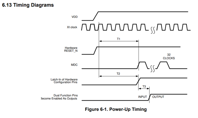

  • Hi Will,
    I notice the reset signal is coming up with the VDDIO, which precedes the clock and other power rails. Can the RESET signal be delayed until all power rails and the clock are stable?
    The datasheet timing diagram has RESET rise with 'VDD'. Since there are multiple voltage rails, it would be good to treat this VDD as the last rail to rise.
    Shane
