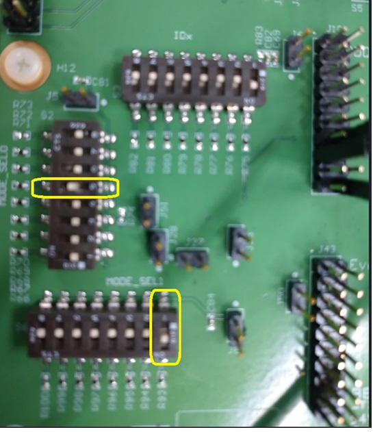

Please advise me resolving my problem on DS90UB947/948EVM.
I connected DS90UB947EVM and DS90UB948EVM, both were set in Dual OLDI mode.
applied 75 MHz PCLK to the DS90UB947, and checked frequency of the PCLOK came
out form DS90UB948.
It was half of the input (37.5MHz).
When the input frequency was increased to 150MHz, the output frequency was 75 MHz.
So, I suspect the DS9094 behaves as dual OLDI mode but DS90UB947 behaves single OLDI mode.
Please advise me on how to configure DS90UB947 in Dula OLDI mode.
I set modes switches as follow:
Mode Sel 1   SW 6.1 = On    OLDI Dual,  Non SS.,  Non Repeater
SW 2.5=On     MAPSLE=1  Coax
Mita

  • Nikolas-san,
    Here are detail my settnigs for the eval boards.
    Mita

  • Hi Mita-san,
    Thank you for clarifying. Apologies for any confusion - please disregard my response on Jul 10 as well as the block diagram on Jul 15.
    The UB947 features dual OLDI ports as indicated by the first page of the datasheet, but it does not have a CLK2 lane since this only applies to certain displays. However, it does accept the even/odd pixel format as indicated in Section 7.3.4 of the UB947 datasheet. These even/odd pixel formats are what is controlled by the OLDI_DUAL mode strap of the UB947. Strapping the UB947 to single-pixel or dual-pixel mode will not halve the CLK frequency since there is only one input CLK lane.
    The UB948 also features dual OLDI ports, but unlike the UB947, this device has both a CLK1 and CLK2 lane. As such, selecting the OUTPUT_MODE strap to either single OLDI output or dual OLDI output will halve the CLK frequency if dual OLDI output mode is selected since there are two input CLK lanes. See the below visuals from the UB948 datasheet for more details:
    With all that being said, what you are describing is in fact accurate. See below for an updated visual of your exact test set-up:
    Let me know if you have any other questions.
    Nikolas
