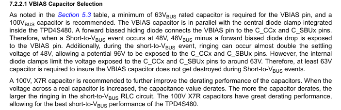

Hi expert,
customers want to confirm that if the short circuit protection of the TPD4S480 is only valide when there is power supply on Vpwr/Vbias?
If there is no supply on Vpwr/Vbias, and the adapter plug in with the CC and Vbus shortage issue, will the PD controller TPS26750 have risks to damage?
