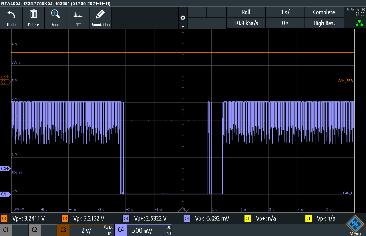

TCAN1043A-Q1: NFAULT Pin High during CAN L Short-to-Ground Simulation
Part Number: TCAN1043A-Q1
Hello Texas team,
CAN part number : TCAN1043ADMTRQ1
During the CANL-to-ground fault simulation, the NFAULT pin remains in the high state throughout the entire fault duration. We expected the NFAULT pin to assert low under this fault condition. Could you please help us to check why the NFAULT pin maintaing high during the fault situation .
