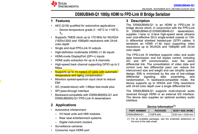

    The datasheet states that "15m communication is possible."
    Could you please clarify the conditions required to achieve this performance?
    (1) Recommended cable specifications and length (including specified components)
    (2) Assumed power supply environment (voltage, allowable ripple, etc.)
    Ishiwata
  • Hi Ishiwata-san,
    Yes, we support cable lengths of up to 15 m when using a proper automotive coax cable, such as a 535-3 cable with HSD connectors. However, a 0.2 m cable is actually too short and can degrade the return loss, especially when using SMA cables and connectors.
