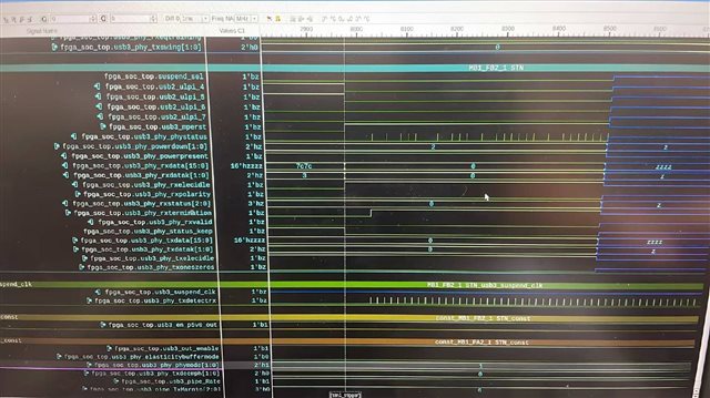

  • Hi Brian,
    Thanks for your quick response. Attached is the overview of sequence. Let me give some explanations one by one.
    #1 OUT_ENABLE keeps 1 after FPGA programmed, const assign in RTL.
    #2 USB3_PHY_MODE keeps 1 after FPGA programmed, const assign in RTL.
    #3 USB3_RESETN is under manual control. After bitstream download, we manually open the debug window and complete trigger configuration before deasserting the reset. Therefore, the USB3_RESETN signal transitions from 0 to 1 roughly tens of seconds after FPGA power-up. Shown as usb3_mperst in waveform.
    #4 For RX_ELECIDLE, we used it as input signal and probed it. The RX_ELECIDLE is controller by 10k pull-down on PCB, which makes RX_ELECIDLE keeps low during USB3_RESETN is low in waveform.
    #5 For ULPI_DATA4~7, we only probe them on the FPGA side. Their values are entirely determined by the PHY together with pull-up and pull-down resistors. Switch S3 controls a 10k pull-up on ISO_START (switch in direction of pin 1) or a 10k pull-down on ISO_START (switch in direction of pin 3). Now I control the S3 to use 10k pull-down. BTW, although we have pd/pu on these signals in PCB, if I leave ULPI_DATA4~7 floating, the power-on sequence is very strange, phy-status will keeps 1 and never go down. After I pinlock them and probe them in FPGA, power-on sequence is  as expected.
    #6 We previously used the pclk signal for probing. Based on PLL lock status and waveform length measurements, the pclk frequency is 250 MHz.

  • If mperst is is reset signal  then strapping looks ok. But it seems pin J11 (RESETN) and pin J3 (PHY_RESETN) was connected  together in your design. PHY_RESETN should be connected separate from RESETN and should be controlled by a FPGA  IO

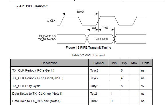

    2: how about trace length for  PIPE signals ? should be < 2 ins, and how about trace length matching  for PIPE signals?
    3: can you look at TX data vs TX_CLK to see if meet timing spec. ?

    #3 For trace length, I will try to double check with RnD, Given our extensive hardware R&D experience, we can first assume there are no errors stemming from such issues.
    #4 No IDELAY is implemented for the PCLK signal after entering the FPGA on customer design.
    #5 TX_CLK is not routed through an ODDR primitive on customer design.
    #6 We will measure the timing of TX data and TX_CLK next week after the customer’s hardware engineer completes the flying wire connections.

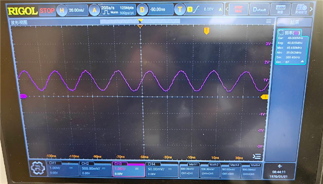

  • Crystal output should be around 1.8V, but it was only 1v from your waveform, you may need to add 1 Mohm resistor between XI/XO.
    Best
    Brian
  • Hi Brian,
    No offense intended—thank you for the suggestion. But according to Table 3-5 of the TUSB1310A datasheet, the 1.8 V specification appears to refer to an external clock applied to XI. When a passive crystal is connected between XI and XO, these pins operate as analog oscillator nodes, so the XO waveform is not necessarily expected to reach a 1.8 V logic level.
    In our measurement, the crystal oscillates steadily at 40 MHz, and the PHY generates a locked 250 MHz PCLK. These results suggest that the oscillator and internal PLL are operating correctly.
    Therefore, it may be helpful to confirm whether the 1 MΩ resistor is specifically recommended for this device. TI’s typical crystal connection does not show one, although we may add one in the further debug.

            .rx_detect_result(led_rx_detect_result), .fsm_state(led_fsm_state)
    endmodule
    Related to RESETN and PHY_RESET_N, https://github.com/mossmann/daisho/tree/1d2f5e1cb16a9a724f957cc6c99e63b601e5cac0 shows a example to use altera FPGA to control TUSB1310A. RESETN and PHY_RESET_N are almost the same one in the design, because the phy_pwrpresent should be 1 after FPGA power on. So I think the RESET issue may not the root cause of this issue.
    At this point, I seem to have reached a bit of a roadblock and am not quite sure what to investigate next. No offense intended, and I really appreciate your suggestion. Do you have any other recommendations or areas you think would be worth checking?
    BRs
    Zhichao

      If PCLK is stable, then crystal should be fine without 1 Mohm resistor..
     Did you get PIPE trace length information? Did you get chance to measure timing between data and TCLK/PCLK? It's  critical to do timing deskew for PIPE.
    Brian
