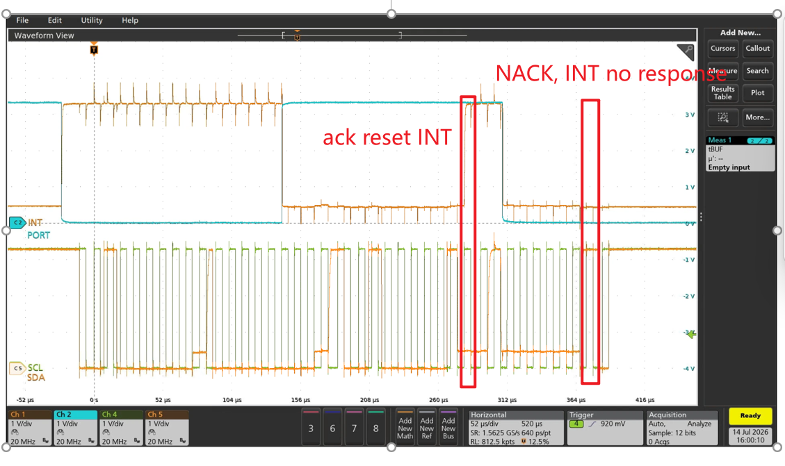

Hi Experts,

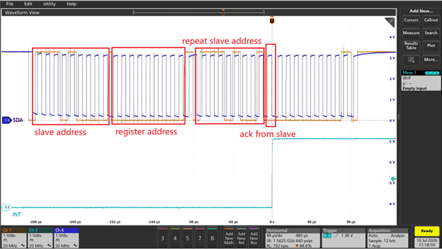

your datasheet page 20 descript "INT resetting occurs in the read mode at the  acknowledge (ACK) or not acknowledge (NACK) bit after the rising edge of the SCL signal. "
i really see INT will reset at ACK, but i don't see any response at NACK.  Can you explain what scenarios  INT will reset at NACK,it should be better if you can provide waveform.
