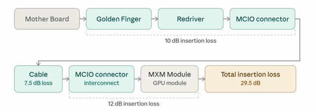

Here is the quick overview of our project architecture and loss budget:
  • Path: Gold Finger → Redriver → MCIO → MXM (running PCIe Gen5)
  • AIC Insertion Loss Baseline: 9.5 dB
  • Cable Loss: 7.5 dB
  • MCIO to MXM Module Loss: 12 dB
  • Gold Finger → Redriver → MCIO Loss: ~10 dB (Estimated)
  • Required Redriver Compensation: At least 20 dB
Request: Could you please help evaluate the routing/schematics for the Gold Finger → Redriver → MCIO segment? We would appreciate any feedback, suggestions, or corrections you might have.
I will send the schematic via privacy message. thanks!
