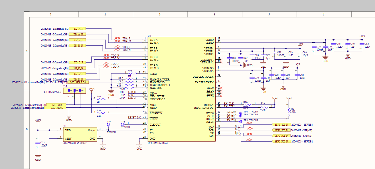

I still fail to have a 1GBps link between fiber and copper. I managed to get the link on the new purchased evaluation board, and was able to compare the register of the EVM with my own.
I try to have a link between my board and a commercial media converter. There seems to be no fiber link and my PC detects no ethernet cable at all. I see some activity on the magnetics, but not on all pairs.
My PHY
Register 000A is: 0000
Register 0010 is: 5048
Register 0011 is: 0002
Register 0014 is: 29C7
Register 0017 is: 1140
Register 006E is: 1800
Register 01DF is: 0004
Register 0C00 is: 1140
Register 0C01 is: 6149
TI EVM:
Register 000A is: 3800
Register 0011 is: BF02
Register 0017 is: 0040
Register 0C01 is: 6169
If any other registers are relevant to check, I can take care of that.
any help is appriciated!
Thank you!

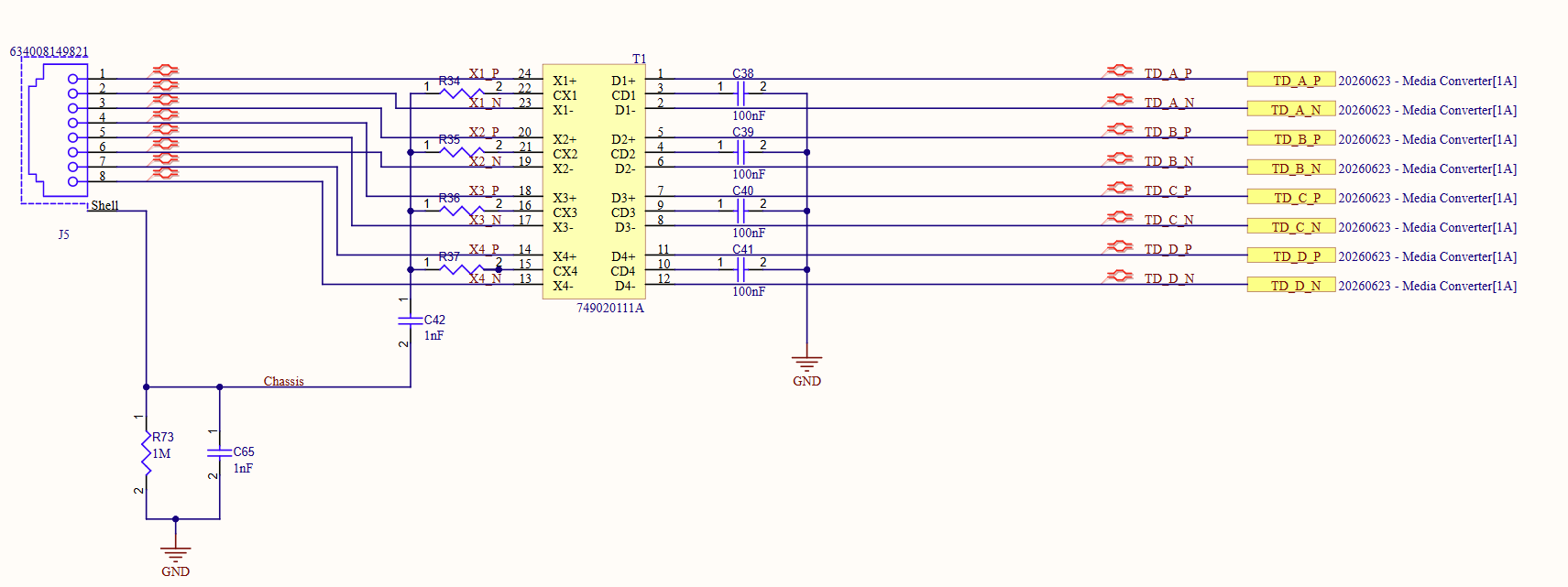

    The magnetics implementation looks correct in your schematic, and the fact that register 0x1DF is 0x0004 shows you are in the correct mode. I am wondering why 0x006E is 1800 in your design, as this would mean mirror mode is enabled.
    Mirror mode swaps the channels between the PHY and the magnetics so that channel A becomes channel D, and B becomes C. This makes sense on our EVM, as the channels are swapped via trace routing between the PHY and magnetics (Channel A goes to pins 7&8 of the RJ-45):
    However in your design, the channels are not swapped (channel A goes to pins 1&2 of RJ-45 connector). So you would not want mirror mode enabled. Can you remove the strap pullup on RX_CTRL and see if the copper links up?
    If this still does not link up, disable link loss pass trough by pulling up the RX_CLK strap. This will make it so the copper and fiber links can succeed independently. Link loss pass through will prevent a copper link from establishing if there is no fiber link, and vice versa:

  • Mirror mode swaps the channels between the PHY and the link partner. By looking at the schematic, you can see the EVM swaps these channels, as channel A is routed to pins 7/8 of the RJ-45 when it would typically be routed to pins 1/2:
    This means our EVM requires mirror mode to work (hence the 'Mirror Mode Enabled') note on top of the magnetics here. In your schematic I can see that channel A is routed to pins 1/2 of the RJ-45 connector. This means you should not enable mirror mode, or else the PHY would expect channel A on pins 7/8 of the RJ-45, which is actually channel D in your schematic.

    The schematic implementation of the magnetics and connector looks ok as well (assuming the magnetics component is meeting our datasheet specs I showed earlier). A full list of health checks can be found in our DP83869 troubleshooting guide, and I recommend looking through this to see if there are other deviations from expected signals around the PHY.
