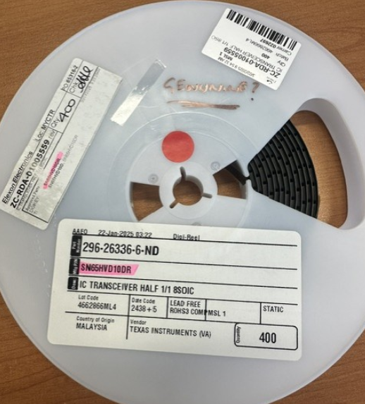

  • TI Part Number: SN65HVD10DR

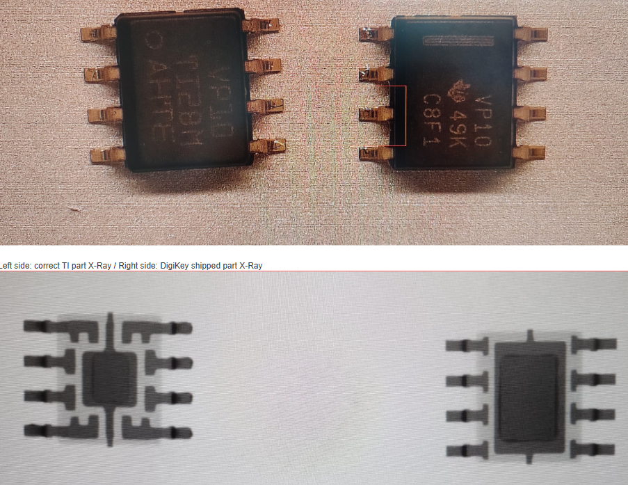

Customer Concern: The customer reports that the top marking and X-ray image of the received devices differ significantly from previously used SN65HVD10DR parts.
Our customer would like to have a marking confirmation to see if they received a right part and get to know the meaning of marking below
