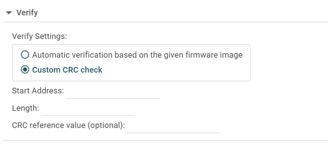

  • Hi Brian,
    ah okay thanks for the information.
    How can I make this validation stop failing?
    Timo
  • Hi Timo,
    You can customize the verification settings in Uniflash here:
    These settings should be kept when you generate the standalone package too.
    Brian
  • Hi Brian,
    thanks for this information - I will give it a try.
