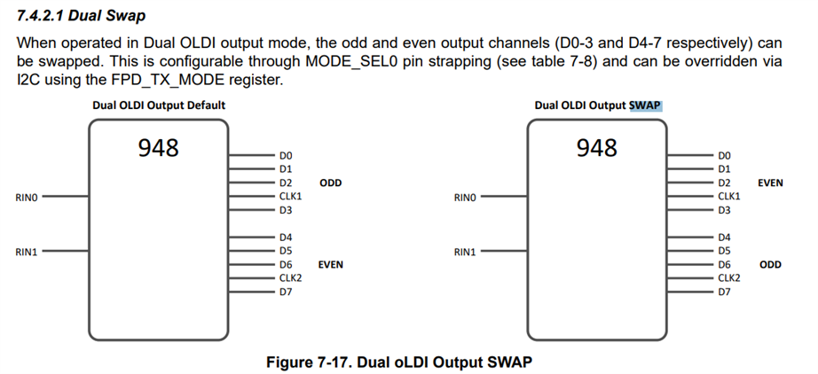

    3. We would need more information about this to narrow down, but on first glance this seems like a pixel-swap issue. It's possible that the output of the 948 ODD/EVEN pixels are connected to swapped ports of the OLDI receiver.
    Please check the "Dual Swap" section of the datasheet that shows how it can be swapped using either MODE_SEL0 or overwritten via registers:
    "When operated in Dual OLDI output mode, the odd and even output channels (D0-3 and D4-7 respectively) can be swapped. This is configurable through MODE_SEL0 pin strapping (see table 7-8) and can be overridden via I2C using the FPD_TX_MODE register."
    If this initial configuration does not resolve the issue, them please provide more information about the working vs non-working issue cases so we can compare.
