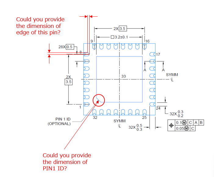

Part Number: TPS26742-Q1
Hi team,
My customer is considering TPS26742-Q1 and there are some dimension missing in datasheet. Could you please confirm the dimensions in red below? (estimation is okay)
Thank you,
Muwei Zheng
Hi team,
Thank you,
Muwei Zheng

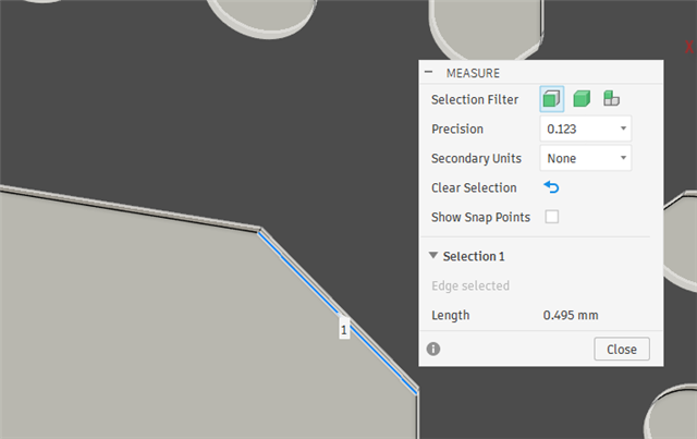

Hi Ke,
Would you kindly help confirm the exact dimensions, since I don't have access to the software required to open the 3D model? Thank you for you support here. I have attached the model below.
ul_TPS26742AAQRHBRQ1.zip
