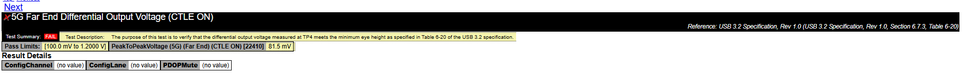

We encountered an issue during USB testing. While testing USB 3, the EQ eye diagram is not wide enough.
Please find the attached test report. Could you kindly advise if you have any recommendations for the EQ settings?

Hi AE,
Yes, this product is used in a monitor application.
Currently, both the SSEQ and CEQ settings are configured as Equalization Setting 3.
