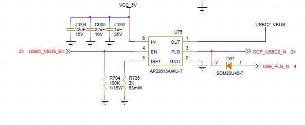

Hi TI team,
I am using the TUSB321RWBR as a CC controller. The circuit diagram is shown below. When I connect an external hub, I find that the DIR pin outputs a high level, which is not the expected low level. Then I removed the hub and connected the USBC_CC1 signal on the board to ground through a 5.1k resistor (to simulate a Type-C interface connected to a device). At this point, the DIR pin still outputs a high level. Next, I only connected USBC_CC1 to 5V through a 22k resistor and also shorted USBC2_VBUS to 5V (to simulate a Type-C interface connected to a host). The DIR pin still outputs a high level. May I ask what could be causing the abnormal operation of the TUSB321RWBR?
    Can you share a pdf of the schematic?

  • Hi Vishesh,
    The issue has been identified: it was due to a soldering problem – the assembly house placed the chip with pin 1 oriented incorrectly. After replacing the component and re-soldering it properly, the functionality is now back to normal. Thank you for your support.
