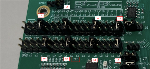

    We have already worked with TI Gen4 redriver DS160PR810EVM-RSC, and since we wanted to do more we procured this Gen 5 redriver, we have been using the GUI since then.
    On the DS320PR810EVM-RSC , the write protect is enabled( on J5 header, EEPROM write enable is tied to GND), and the USB2ANY interface is also connected correctly.
    attaching few images of the same.

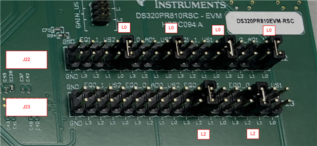

    Thanks for sending pictures of the EVM. Your USB2ANY connection looks correct.
    Could you please double check that your SMBus address strap jumper settings (J15, J16, J22, J23) matches the ones below:
    Charles

  • Hi Vamsi,
    My jumper for J23 was incorrect (J15, J16, J22 remains the same). Please see revised image below:
    On GUI side, ensure device address are configured before hitting "apply". Otherwise, no GUI changes will take affect. For pin settings shown above, please use configuration shown below:
    Charles
