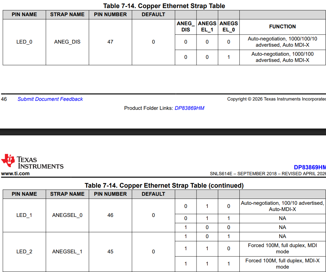

Hi Team,

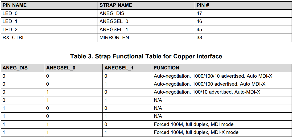

The first picture is captured from the datasheet of DP83869HM while the second picture is from the application note SNLA318.
The positions of ANEGSEL_0 and ANEGSEL_1 appear to be swapped between the two figures, making different strapping for the same mode: e.g. for mode 2 auto-negotiation, 1000/100, first picture indicates ANEGSEL_0 = 1 and others = 0. But the second requires ANEGSEL_1 = 1 while the others = 0.
So which one is correct?
Picture from datasheet
Picture from SNLA318
