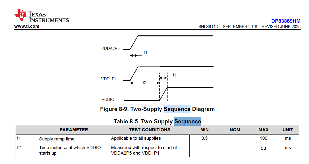

Into the DP83869 datasheet there is a requirement on the power on sequence :
It seems that DP83869EVM have no mechanism to respect the t2 time max of 50ms.
What are the impact to not respect that ?
Ensure that Reset pin is maintain low release this constraint?
Thanks for your help.
