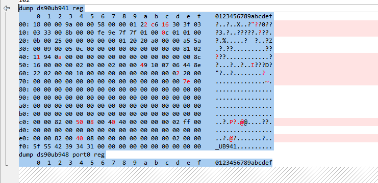

soc-------ds90ub941--------ds90ub948------------lcd
The screen can display normally, but the i2c communication is abnormal. It can read 941, but cannot read or write 948 and tp
Register information dumped after the problem occurred:
  • Hi Zhao,
    Thanks for the 941 register dump, this is helpful information. I've got a few questions about the test setup and what you have tested so far:
    1. How are you communicating to the FPD devices? Is it via a micro USB to onboard USB2ANY, an Aardvark over the I2C pins, etc.?
    2. Are these TI EVMs or custom designed boards?
    3. Have you tried connecting directly to the local 948 I2C bus to see if it responds?
    4. Do you have any initialization code you ran before this register dump that you can provide?
    5. Do you have a logic analyzer capture of the I2C transactions you attempt to send to the 948?
    BR,
    Cameron

    4.If the value of the 0x0c register of ds90ub941 is 0x16, the link should be completely blocked. Why is the video signal normal? Only the i2c is abnormal

    I also noticed that in registers 0xA and 0xB of the 941, that there are a large amount of CRC errors on the link. This usually indicates a link integrity issue with the FPD channel, especially since you stated the 948 works and can communicate initially, but then goes bad after some period of time. You could try changing out the FPD cable to see if the issue is being caused by a faulty cable. Has a schematic review or layout review been completed by TI for this design in the past?

    Since video seems to be functioning while the 941AS is reporting no link/lock and no I2C communication to the 948, it sounds like there is a gross back-channel margin issue. This is backed up by the fact that there are a large amount of back-channel CRC errors, further indicating an issue with the back channel.
    My first recommendation would be to change the cable being used for a new one. This should eliminate any potential issues with the cable. Is this a coax implementation or an STP implementation?
    My second recommendation would be to send the schematics for your 941 and 948 for me to review.
    If these two things don't reveal anything, we will need to likely have the problematic units taken out of the vehicle and instrumented on a bench for testing. This would be to see if the issue follows the deserializer, and to be able to run custom I2C transactions to the units.
    Could you additionally confirm if this issue is seen right after start-up or if it occurs after a period of time? And is this on a 0km vehicle?

  • At present, this problem has been resolved after reconnecting the screen cable, and it has not occurred again.
    Glad to hear the issue appears to be resolved. I would recommend monitoring registers 0xA and 0xB on the main page of the serializer to check for large amounts of CRC errors. My guess is that the cable wasn't fully seated correctly and was causing a marginal link between the serializer and deserializer, resulting in the issue you saw.
