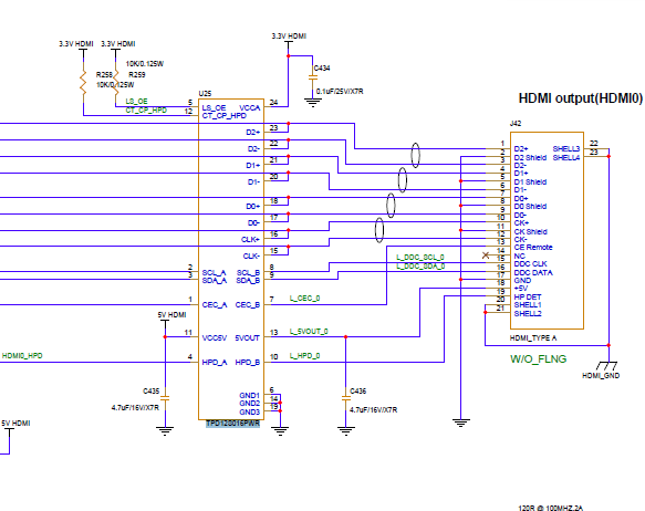

I am planning to use the TS3DV520 as an HDMI multiplexer to switch between two HDMI interfaces.In the current version of our board, the processor supports only a single HDMI connection. For the next board revision, we are planning to support an additional HDMI interface by using the TS3DV520 as the switching device.
  • Do you have any reference schematics, reference designs, or application notes that demonstrate the recommended implementation of the TS3DV520?
I have attached the schematic of our current design for your reference. Any feedback or recommendations would be greatly appreciated.
  • Hi Tejas,
    I do not see any issues with implementing the TS3DV520 to switch between two different HDMI interfaces.
    Please see the applications section of the datasheet or this document on HDMI here for more info.
