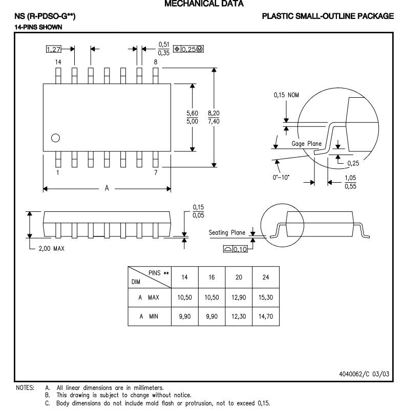

Hi Team,
Regarding part AM26LV31INS, for the specified package NS(R-PDSO-G16), the mold flash or protrusion should not exceed 0.15 mm. Could you please confirm whether this 0.15 mm limit applies per side or in total?
Additionally, please confirm whether the mold flash should be considered only at the A value or at both A and 5.6 mm side.
