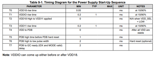

  • Hi Vijay,
    Thank you for your patience. Below is the power-up sequencing requirements for your reference:
    As a beginner to this SerDes family, is there a specific, strict register write order required at boot time to get the chip out of power-down and force it to lock onto a 25 MHz reference clock?
    No programming sequence is required for the reference clock detection. Key item here is to follow the power up sequencing as documented above. The deserializer has an internal oscillator to allow for I2C communication in the event the reference clock is not detected. Below are the REFCLK specifications:
