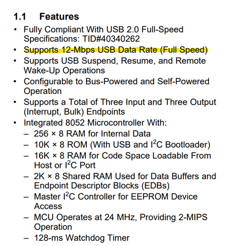

Whether TUSB3410 integrated driver too? Sorry I am not familiar with protocol device, seems customer requests not only the device can auto-switch UART & USB but also no additional driver installation for the host computer(PC, USB).
And they need it support 12MHz. Could you please help check again? Thanks.
BRs,
Francis
The TUSB3410 will require a driver install for operation.
The TUSB3410 does have USB 12Mbps is this what you mean?
