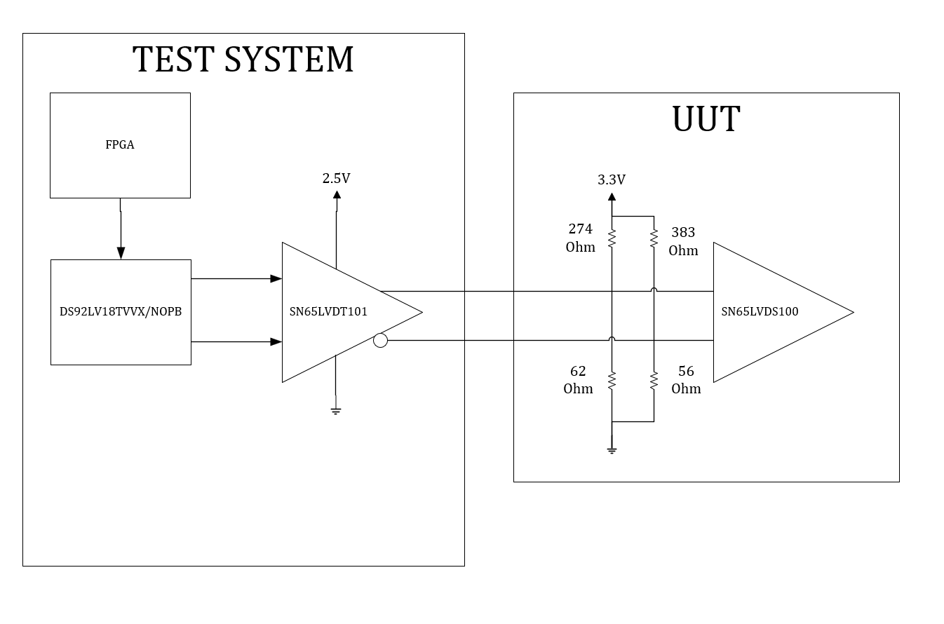

We are working on testing system and want to use your part as described in diagram below. Does this configuration will work? Screenshot 2026-08-03 004214.png
  • We can't change the UUT and the team of the UUT side used before that TLK1521 in the test system, but now it's obsolete. So we are looking for the TLK1521 replacement. The bandwidth should be ~450Mbps.

    SN65LVDT101 has a VCC range of 3.0 to 3.6V, so the 2.5V power will cause issues. Do you have 3.3V rail on that board?

    Thank you for the reply! I looked at datasheet again after I posted the question, I can supply SN65LVDT101 with 3.3V too, the question - will it work with the Thevenin termination circuit?
    I did the simulation of generic LVPECL output driver and in simulation the voltages are in the acceptable ranges of the SN65LVDS100. Or another option is to use SY89327LMG-TR with 3.3V instead of SN65LVDT101 with 3.3V.
    I found in the datasheet of TLK1521 that there was built-in termination for output drivers, but can't find any information or circuit for this termination, also the client can't tell what was his calculations when he developed the original version with TLK1521.

    Ideally, you should have symmetrical termination where the pullup and pulldowns on each line are equal value to avoid impedance mismatches. (see below). However, if this was done because of fail-safe biasing to introduce an offset in the event of an open circuit, then it should be fine.

  • Thank you for the explanation. Yes, we can't change UUT side so we need to adapt ourself to it.
