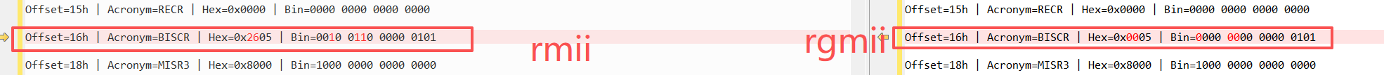

The only difference of register between RMII and RGMII is 16h.

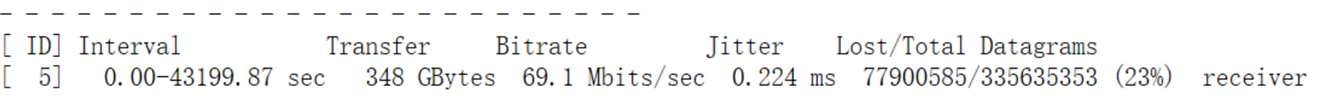

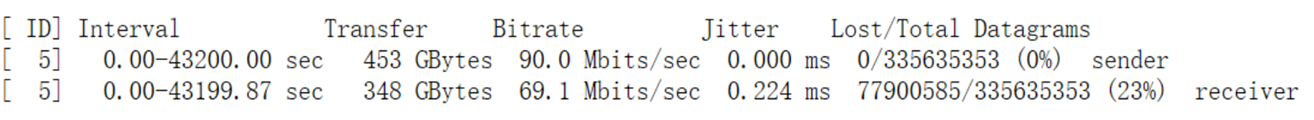

    I’d also like to add a bit more information: I tested the RMII link using iperf3 yesterday, and there was about 20% packet loss.

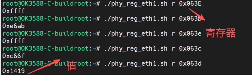

  • Hi Gary,
    Please read packet counters in sequence 0x639-0x63e. The results you show above are valid but if packet counters are read out of sequence, they will not increment until cleared with 0x639-0x63e read.

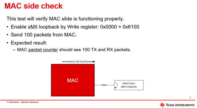

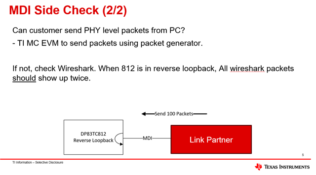

    You can take these steps for debug:
    PHY functionality check:
    • Probe CLKOUT (pin 16). Expect 50 MHz buffered oscillator CLK.
    • Read 0x01: Expect 0x01[2] = 1 for MDI link-up
    • Check sampled strap register 0x45D matches strapping in schematic
    MDI side check:
    MAC side check:
    After performing these 3 tests, you will be able to isolate where packet drops are occurring. Please let me know if you have any questions.
