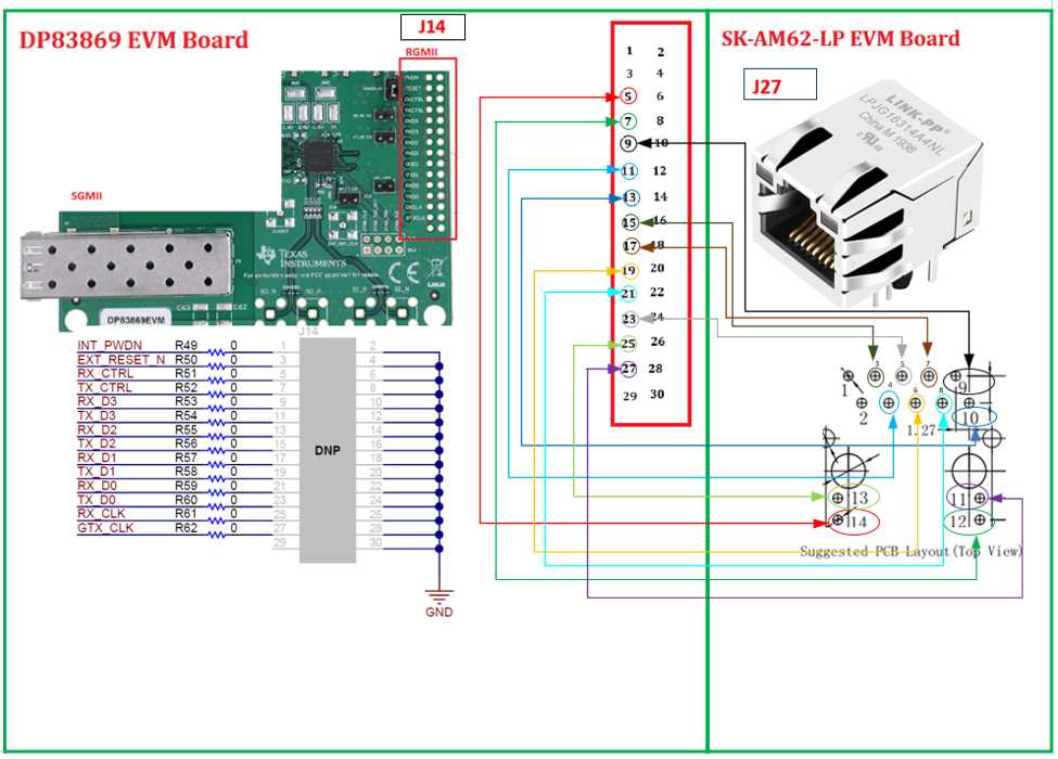

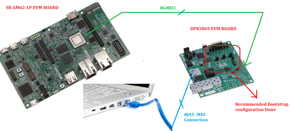

Wiring connection Explanation:
Objective: RGMII interface to MDI interface conversion
We are trying to validate the RGMII interface to MDI interface (RJ45 Connection) at 1Gbps bandwidth.

  • Hi Seenivasan,
    1. The current DP83869 driver is located on our public Github.
    2. The maximum trace length we recommend is 6 inches.
    3. This EVM is not intended for throughput testing (full signal chain). The RGMII routes to probe points/headers on the board that are good for measuring signals coming from the PHY. These probe points are not ideal for a high speed signal (such as RGMII) to pass through.
    4. This is good and indicates you are linked up at 1Gbps
    5. INT is not required to connect to a processor.
    6. This is good
    7. 1Gbps autonegotiation would be set using the OPMODE straps. You should remove any straps on the OPMODE pins to get 1Gbps Copper to RGMII
    8. We do have tips for troubleshooting the RGMII, however this EVM's RGMII connection is not ideal for signal integrity as it uses jumper wires to connect to a second board. This may be ok for 10Mbps, which is lower speed, however for 100M and 1Gbps this connector likely prevents the signal from passing cleanly. For validating the RGMII interface it would be better to use a board with trace connections or a dedicated board to board connector for the RGMII.
