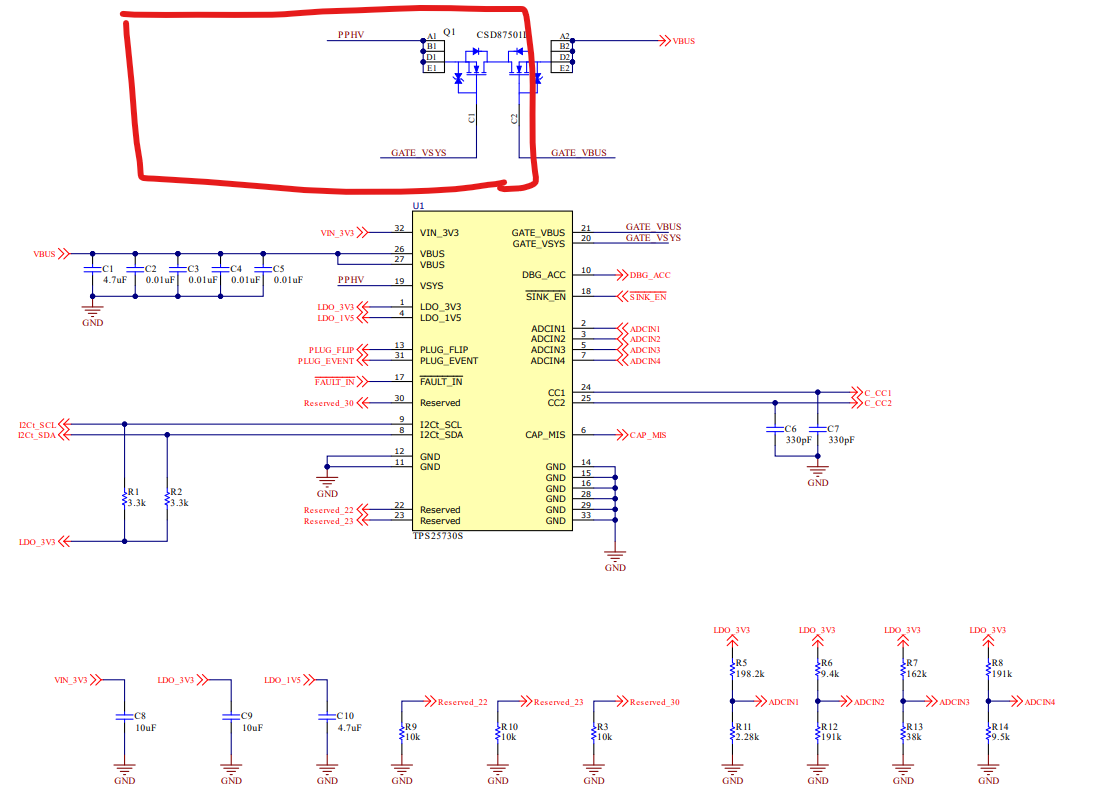

I got a question from customer, could you please kindly help to clarify it?
They are confused that why the application design needs a dual channel FET?
Could you help to clarify if it is mandatory or we can just use a single FET for sink only application?
Thanks.
William Lai
  • Hi William,
    Thank you for reaching out!
    Please see below comparison table for single FET vs dual FET features with the TPS25730. The dual FET solution has reverse current protection while the single FET solution does not.
    Please ensure that VSYS is discharged upon disconnect/reconnect.
    Also, we recommend migrating to our latest device, the TPS25730A. Please see the following FAQ:  [FAQ] TPS25730A: TPS25730A vs TPS25730
