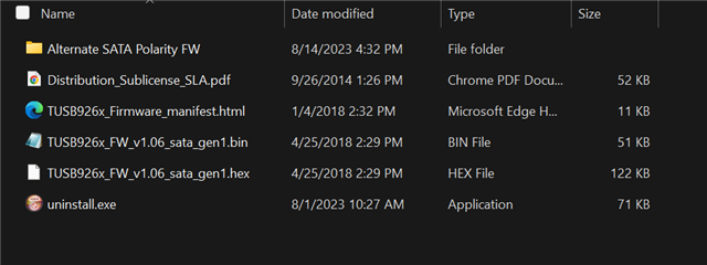

    Which firmware are you using, from the ones available on TI.Com?
    ==> Yes, the ones available on TI.com. In other word , we purchase a new again from digikey and test with fresh firmware.
    Which firmware? The one that comes default from the Firmware.exe?
