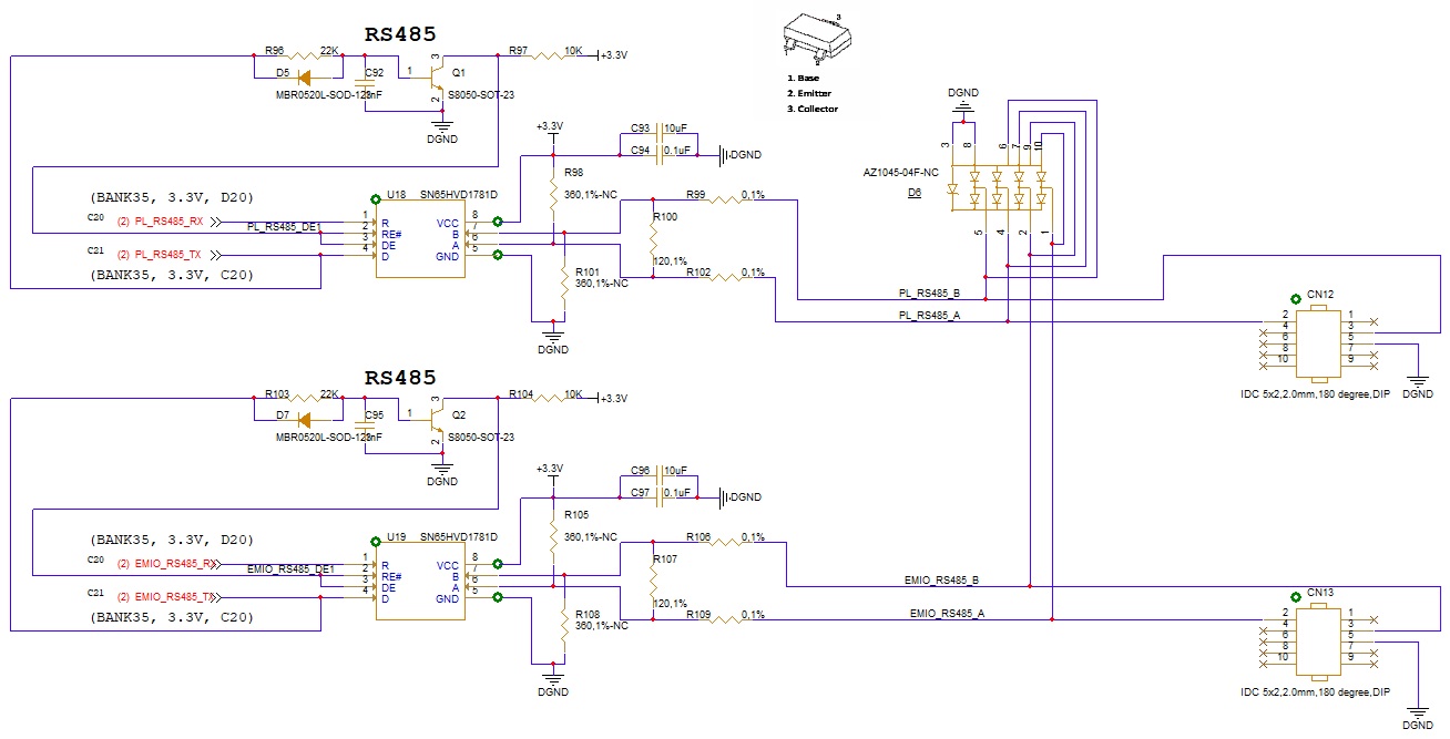

SN65HVD1781: SN65HVD1781D can't receiver text data
Part Number: SN65HVD1781
Hi Ti,
I bulit two pieces of SN65HVD1781D in my FPGA board, the schematic is as below, I am trying send text data from NB through USB to RS485 cable to SN65HVD1781D in the FPGA board, it looks like that the SN65HVD1781D can't receive text data from NB, what is wrong in the schematics ?
The component AZ1045-04F is removed out of the FPGA board now.
R98, R101, R105, R105 are uninstalled
Jerry Wu
  • Jerry,
    Are you able to probe the A and B pins of the receiving unit and do a math function of A-B?
    Can you also probe the receiving unit and verify the RE# pin is set to a logic low?
    -Bobby
