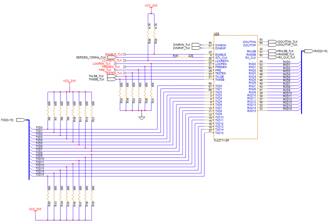

Would you kindly check the schematic below and confirm if the pullup, pulldown and caps are enough?

Hi Marvn:
there is no need to add external resistors for since there are internal PU/PD resistors.
external 4.7K pull-up resistors for ENABLE, LOCKREFN
external 10K pull-down resistors for LOOPEN, PRE, PRBSEN, TKLSB, TKMSB.
For TDx pins, if not used, external PU or PD are needed.

Hi Brian,
I have follow up question. There seems to be a contradiction in the datasheet:
On page 5 (Pin 43), the datasheet states:
However, Section 6.3.9 contradicts this:
And Section 6.3.12 further confirms:
It appears to me that All 16 RXD pins (RXD0–RXD15) are synchronized to RXCLK, not just RXD0-9. Can you confirm?
Marvin
correct, All 16 RXD pins (RXD0–RXD15) are synchronized to RXCLK.
