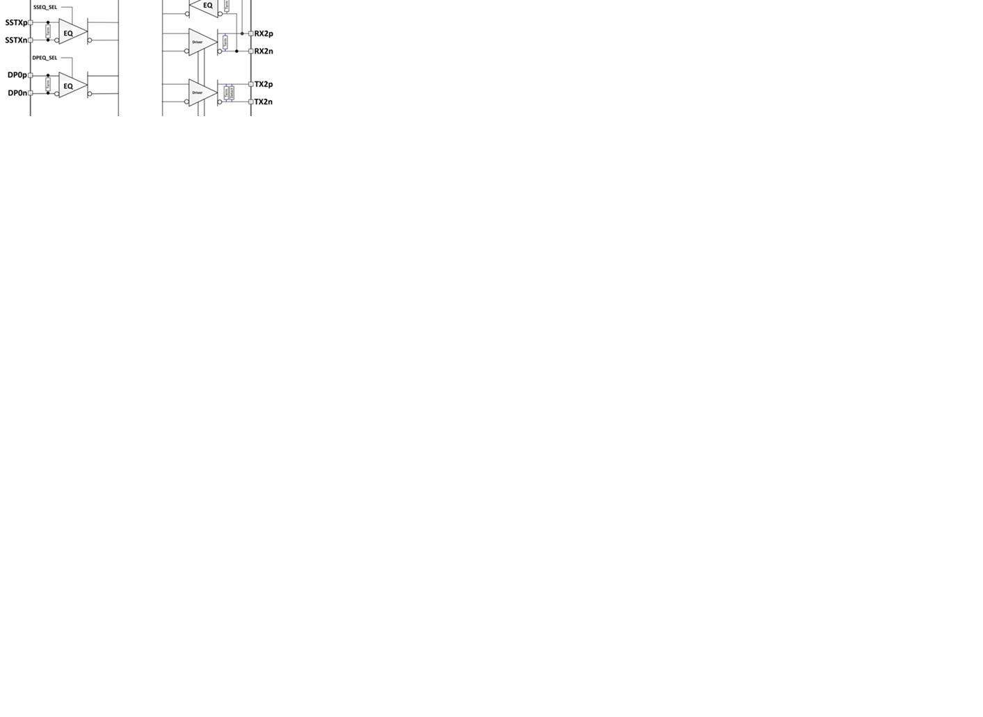

1. According to datasheet 8.2 Functional Block Diagram, is the SSTX's EQ, the so-called Linear Redriver, a function that compensates for the routing losses from the module/CPU/PCH to the TUSB1146, ensuring the signal read by the TUSB1146 isn't too messy?

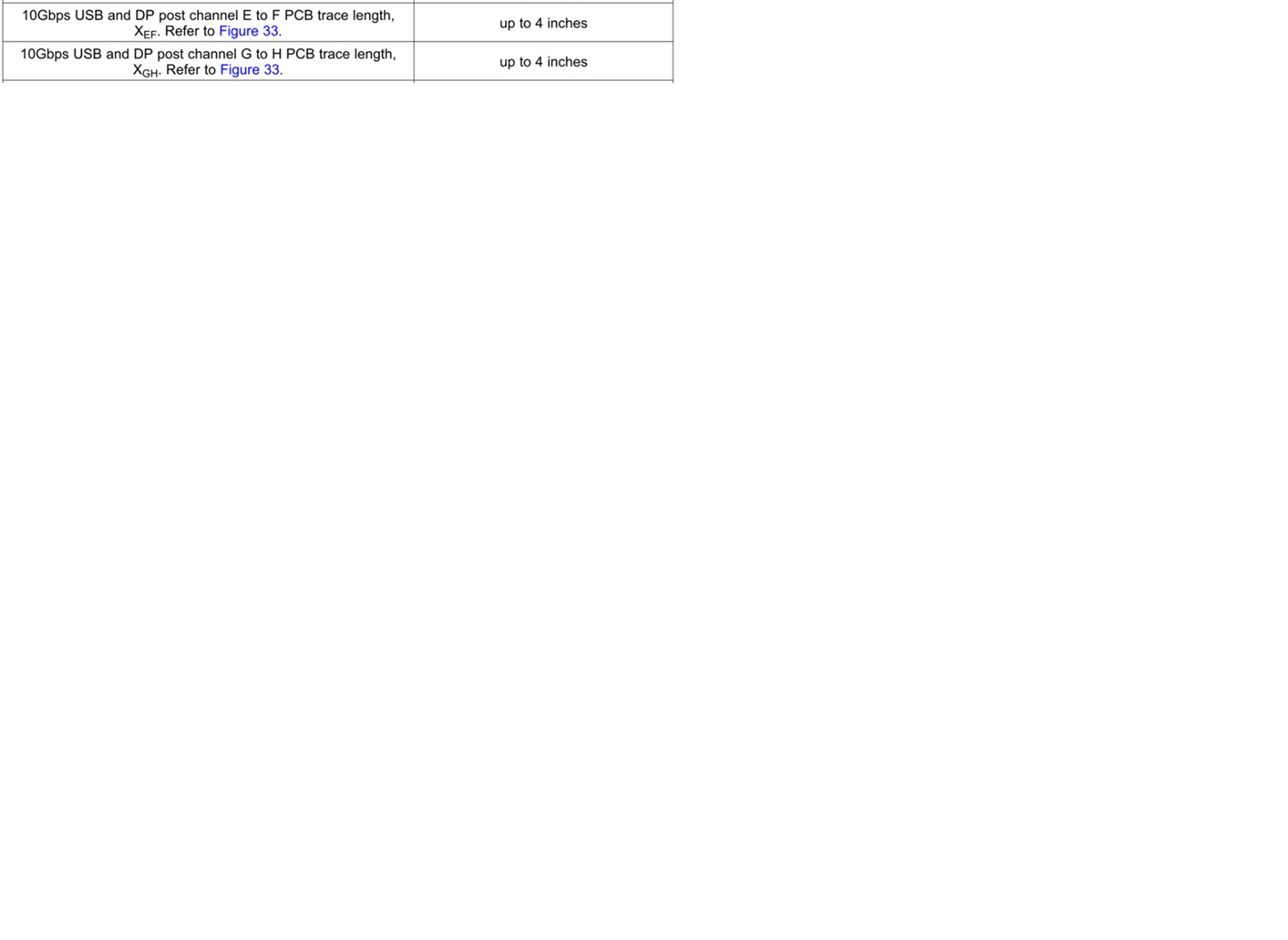

2. The driver after the MUX can retransmit the signal, but regardless of the original module/CPU/PCH's driving capabilities, subsequent wiring is limited to 4 inches.

    The TUSB1146 functionality is highlighted below. The regions in green will be compensated for, the regions in red will need to be compensated by the host or the downstream USB device.
