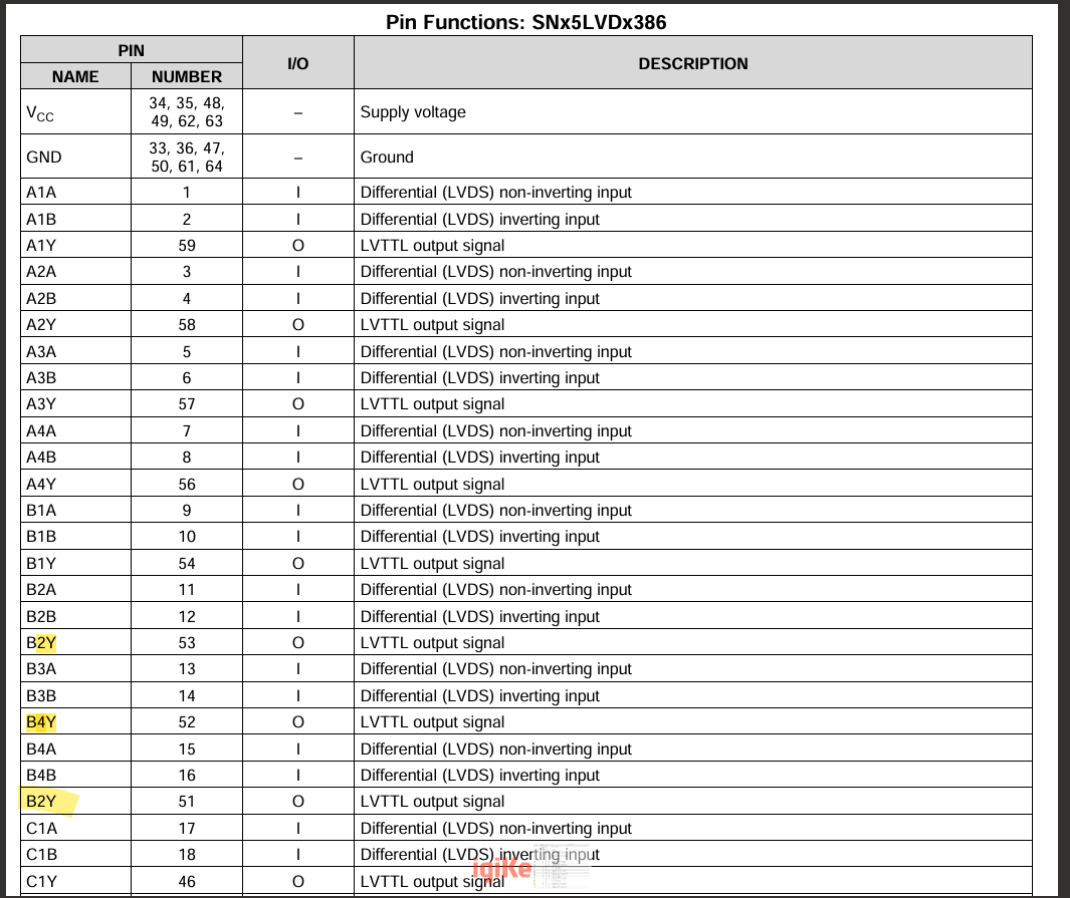

I would like to clarify something regarding the SNx5LVDx386 datasheet.
I noticed that the highlighted section appears to have a duplicate entry. Specifically, B2Y is listed twice (Pins 53 and 51), while B3Y does not appear in the table.
Could you please confirm whether this is a typo in the datasheet or if there is another explanation?
I've attached a screenshot for reference.
