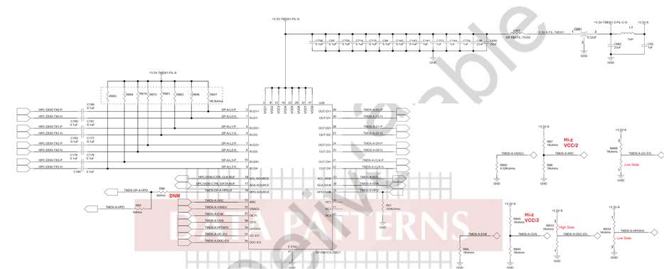

We are using SN75DP139RSBT chip used to conevert DP++ to TMDS data from GPU.  While read EDID data from GPU to DVI sink we are getting error unable EDID data. While probing chatter and 0.5V offset on the DDC-I2C data lines.TMDS.zip Suspecting the OVS pin and it is connected as a resistor divider (1KOhm).

    Can you please share your schematic for review? The OVS pin can be set to either H, L, or Hi-Z state. If you change the OVS strapping level, do you see the 0.5V offset goes away?

    Kindly find the attached schematic below.
    Initially OVS pin is configured as offset 3 (Hi-z - 1Kpullup and pulldown). Later 1Kohm is replaced with 20KOhm. Then 20Kohm pulldown (offset 2) also changed. But still we are facing the same Glitch and 0.5V offset in the datalines.

    1. You are AC coupling the DP139 input, why do you have 50ohm termination to 3.3V?
    2. What is the pull up resistor value on SCL/SDA_SOURCE and SCL/SDA_SINK?
    50Ohm termination is not mounted in circuit and from GPU we forcing video output and we are getting video output from GPU to DVI sink via TMDS (SN75DP139) chip. But through DDC-I2C lines only facing the Glitch and 0.5V offset in the DDC EDID communication.
    Initially 4.7Kohm mounted in both  SCL/SDA_SOURCE and SCL/SDA_SINK, due to raising issue on clk and data lines, 1Kohm value changed both SCL/SDA_SOURCE and SCL/SDA_SINK side.

    If SCL/SDA_SNK is connected to a HDMI receptacle, then you need to follow the HDMI spec and use 1.5k to 2k pullup resistor to 5V.
    But OVS is expected to offset the output low voltage on the DDC Source as shown below depending on its input logic voltage.
    Looking at the waveform, it looks like the SDA_SRC is not being pulled all the way to 3.3V by the external resistor. DP139 can only drive SDA_SRC low, it can not drive SDA_SRC high. If it is not being pulled all the way high, is the source DDC signal a CMOS, instead Open Drain I/O?
