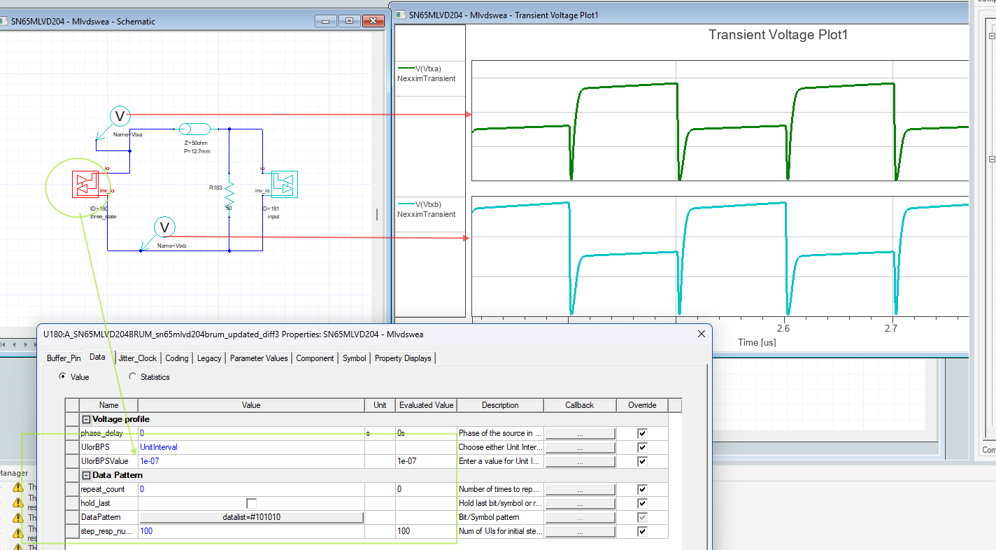

I am currently evaluating the IBIS model for SN65MLVD204B, which I downloaded from the TI website:
www.ti.com/.../SN65MLVD204B
I am using the model in Ansys Circuit Simulator to perform eye diagram simulations. During my analysis, I observed that the outputs at Port A and Port B exhibit different behaviors, whereas I would expect the differential outputs to behave more consistently.
Could you please help us with the following?
  1. Verify the correctness and integrity of the provided IBIS model.
  2. Clarify whether the observed differences between outputs A and B are expected behavior for this device or the IBIS model.
  3. Provide any guidance regarding simulator settings, model limitations, or known issues that could affect eye diagram simulations.
  4. Let us know if there is a recommended simulation setup for accurately evaluating the SN65MLVD204B using the TI IBIS model.
We would appreciate your assistance in understanding the root cause of this behavior and confirming whether the results we are seeing are consistent with the device characteristics.

  • Hi Manohar,
    Our engineer who now covers MLVDS devices is out of office currently. He will get back to you when he returns next week.
    However, one thing I notice is that you only have one 50Ohm transmission line component on the top line and nothing on the bottom line. I haven't used Ansys before, but it seems like you don't have matching lines for the differential signal. Also, MLVDS requires two 100Ohm termination resistor on either end of the bus. I understand two 100Ohm resistors in parallel equates to 50Ohms but if the transmission line component simulates a cable length, this could affect performance.
    Matt
  • Hi Manohar,
    We don't have much guidance in terms of IBIS simulations in general, since the simulation environment is so important here you may try getting advice from Ansys. Matthew's feedback regarding the 100Ohm termination applies, and you also likely want a second transmission line component on the negative signal line, at that 12.7mm default length it likely wont make a noticeable difference in simulation.
    All that said, I've confirmed I am seeing the same on my end in Ansys, I'm running a few more checks on my end to see if this is a nuance of the half-duplex device (i.e. check if the receiver and transmitter portions are somehow active at the same time).

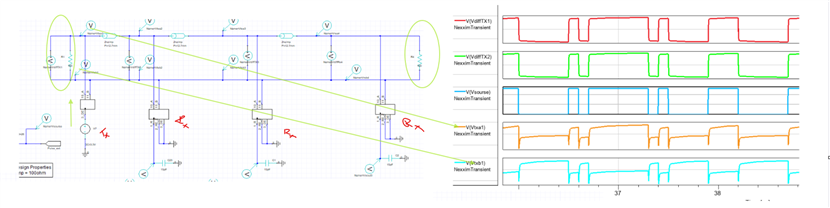

  • Hi Matt and Brandon,
    I have tried the approach you suggested; however, I am still observing similar results when viewing the signals at both the transmitting node and the receiver node.
    Could you please take a look and let me know if there is anything else I should verify in the simulation setup?
    If we look at the waveform below, I can see that the Vout signal at the receiver (Rx) is producing different results compared to the source signal (blue trace).

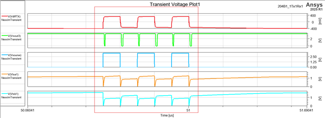

  • Hi Brandon,
    Thank you for sharing the modified IBIS file. The updated model appears to have resolved the rise/fall time issue that I was observing. The signal transitions now look much cleaner, and the waveform behavior is more stable compared to the previous model.
    However, I am still seeing the receiver output, V(rxout3), switching between 0 V and 1 V. Based on my understanding of the datasheet, I would expect the receiver output levels to be closer to 0.4 V (LOW) and 2.4 V (HIGH). Could you please confirm the RxOUT voltage levels you are observing with the modified model?
    A few observations from my simulation:
    • The source input (V(source)) is switching between 0 V and 3.3 V as expected.
    • The differential transmitter output (V(diffTX)) is approximately ±584 mV (about 1.17 Vpp differential).
    • The differential line voltages are:
      • Vtxa1: 0.945 V to 1.529 V
      • Vtxb1: 1.529 V to 0.945 V
    • The common-mode voltage is approximately 1.24 V and remains fairly constant.
    • The differential pair appears complementary, with no obvious distortion or excessive ringing across the 12.7 mm, 50 Ω transmission line.
    • Data received at RxOUT follows the transmitted pattern correctly, but the output amplitude remains limited to 0 V to 1 V.
    Could you also verify the voltage levels at the following test points in your simulation?
    • V(diffTX)
    • Vtxa1 (TX+)
    • Vtxb1 (TX−)
    • RxOUT
    This will help me compare your results against the Ansys simulation and determine whether there is any significant deviation. If the voltage levels are considerably different on your side, I can also discuss the discrepancy with the Ansys support team.
    Reddy

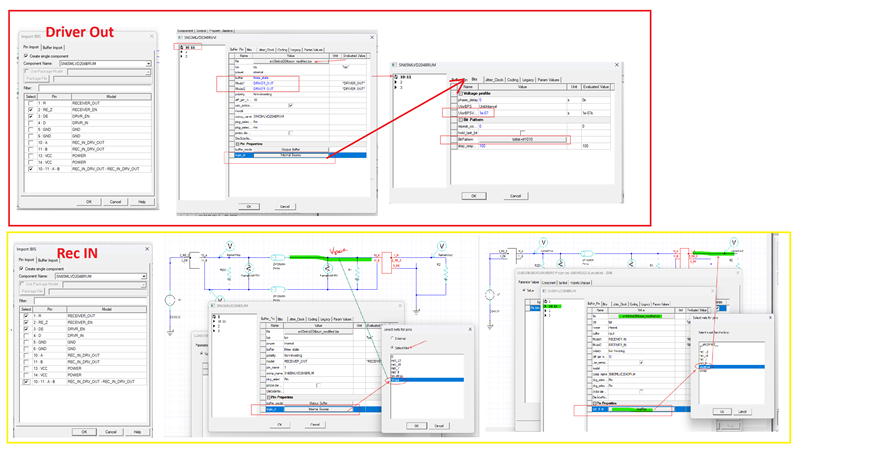

  • Hi Brandon,
    Thanks for the clarification.  I have tried the same at my end by increasing the output load resistance; however, I am still observing the receiver output switching between 0 V and 1 V.
    I suspect that I may be missing a configuration setting in my simulation setup. I have attached the screenshots ( Driver Out and Rec In side IBIS file import settings ) and the Ansys project file(2025-R1) for reference. Could you please take a look and help me identify what settings might be different compared to your simulation?
    Reddy

  • Hi Reddy,
    I am looking into this still, but I am able to recreate your issue. I think the out_of_in is really an internal logic signal that you can probe to verify the device, and tying it directly to the receiver output is likely overwriting it. I am still seeing if i can get this to work on my end based on that understanding.
    Brandon Fisher

  • Reddy,
    See below, the Out_of_in appears to just be 0/1 logic level output, whereas ROUT is above VOH (with 1kOhm load).
    There is probably a better way to do this in Ansys, but i used a dummy net which is just a port tied to ground to a resistor to tie the out_of_in signal to the logic_in signal of the RECIEVER_OUT..
    See RECEIVER_OUT settings below (logic_in tied to Port1 net)
    See RECEIVER_IN Settings (out_of_in tied to Port1 net).
    My hope would be that Ansys would let you do this with a virtual net of some kind, but i don't have enough experience with the tool to say for sure. Perhaps there is another standard solution for tying this. Tying out_of_in directly to the RECIEVER_OUT pin does appear to overwrite the analog output behavior.
    Brandon Fisher
