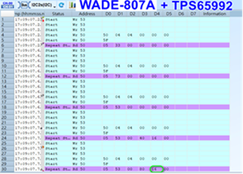

My customer use TPS65992SAE in IPC, which is host side.
It connect a USB4 device but can't recognize 40Gb/s speed.
Is it because AE version doens't support U4 speed?
I checked BH TRM 0x5F Bytes3 has U4, but AE TRM just show reserved.
Thanks a lot!
