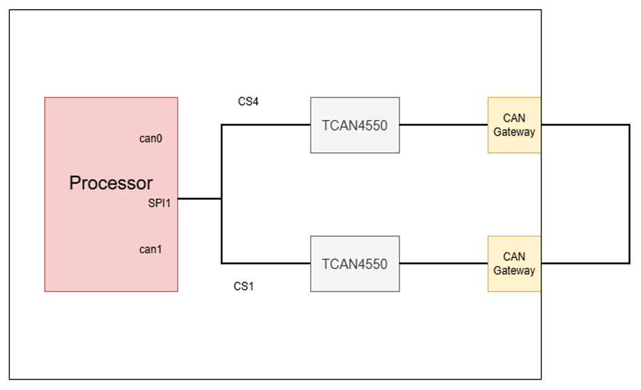

We have used  two TCAN device ( TCAN4550) on same SPI bus ( with different chip select),
During CAN-FD testing between the CAN interfaces, the receiving CAN interface stops receiving frames after some time. When this occurs, the interrupt counters stop incrementing, and CAN communication on the affected interface becomes non-functional.
Setup:
We have two TCAN4550 devices connected to a processor and are testing CAN-FD throughput and performance. We would like guidance on expected throughput limits and recommended validation methods.
 Our setup consists of:
  • Host SoC: Linux based x86 processor.
  • Two TCAN4550 devices connected to the same SPI controller.
  • The two CAN interfaces are connected through external CAN gateways.
  • SPI clock configured at 12 MHz.

Current Test Method
Continuous CAN-FD traffic through CAN (can0->can1) while monitoring CAN socket statistics, Error and interface counters.
Test case 1: Traffic Flow: canFdTester à can0 -> TCAN4550-> CAN GATEWAY-> EXTERNAL LOOP -> CAN GATEWAY -> TCAN4550 -> can1 -> canFdTester
Test case 2: Traffic Flow: canFdTester à can1 -> TCAN4550-> CAN GATEWAY-> EXTERNAL LOOP -> CAN GATEWAY -> TCAN4550 -> can0 -> canFdTester
Traffic initially works correctly. After some time, TX continues normally but RX packet counters, RX byte counters and RX interrupts stop increasing on the receiving interface.
 Interfaces remain ERROR-ACTIVE with TEC=0, REC=0, no bus errors and no bus-off events.

 Observations:
We are testing CAN-FD traffic between the two TCAN4550 interfaces (can0 and can1) connected to the same MxL25641 SPI controller.
During testing, CAN-FD traffic initially flows correctly, and both interfaces show increasing RX/TX counters. However, after running for some time, we observe the following behaviour:
  • Transmission continues normally on the transmitting interface.
  • RX packets stop increasing on the receiving interface.
  • RX byte counters reported by ip -details -statistics link show stop increasing.
  • Interrupt count associated with the receiving TCAN4550 also stops increasing.
  • TX interrupt count and TX packet counters continue to increase normally.
  • CAN interfaces remain in ERROR-ACTIVE state.
  • No bus errors, bus-off events, or error counters are reported.
  • The transmitting interface continues to show increasing TX statistics, while the receiving interface appears to stop processing incoming frames.
  • During long-duration testing, the board occasionally becomes unresponsive and eventually reboots due to a watchdog timeout. Reset reason reported is ATOM WDT RESET.
 Please help to point out the root cause for this.
  • Hello Himanshu,
    Can you dump the device registers to a log so that I can review the device configuration and the value of the various Status and Interrupt registers?
    Because your log files don't show any RX/TX Errors, or a Bus Off condition, I will need to see more detailed information about the device at the moment it stops receiving data.  One possible reason a device would stop receiving data would be due to a Full RX FIFO or dedicated RX buffers preventing the device from storing any new messages.
    Jonathan
  • //can1
    [diag] $ cat /sys/kernel/debug/regmap/spi2.0/registers

    Please find dump of device registers.
  • Hello Himanshu,
    Thanks for the register dump.
    I can see a couple of issues.  The first is with the interrupt register 0x1050 which has bits 0, 2, and 3 set.  These are related to the RX FIFO and has the RF0N bit which is for new messages, RF0F bit which is set when the RX FIFO 0 is full, and the RF0L bit is set when a message is received while the FIFO is full resulting in the loss of that message.
    Your RX FIFO 0 configuration is set to Blocking Mode (0x10A0[31]) so new messages are blocked from being stored when the RX FIFO is full.  This is why the receive counter is not incrementing.
    The MCU should be reading the messages out of the RX FIFO based on the Put and Get Index values in the RX FIFO 0 Status register (0x10A4) and then acknowledging they have been read by writing the index number to the RX FIFO 0 Acknowledge register 0x10A8) which will release the RX FIFO Element to be used again.
    If the messages arrive faster than the MCU can read and acknowledge the messages, then eventually the FIFO will become full and message data will be lost.
    The second issue I see is that your configuration exceeds the maximum amount of MRAM in the device which will cause issues.  The memory cell index wraps around if a location greater than the max cell is addressed which can cause other elements in your MRAM to be overwritten.
    The TCAN4550 only has 2k of MRAM, and your configuration has 64 RX FIFO 0 elements with the maximum 64 byte data fields allocated.  Then you have an additional 4 TX buffer elements with the maximum 64 byte data field allocated as well as 4 TX Event FIFO elements.
    Note that the MCAN IP which was developed by Bosch and licensed to use within the TCAN4550 can support applications with much greater MRAM memory blocks.  However, the TCAN4550 only has 2k so your allocation must be less than 2048 bytes.  The MRAM address range is 0x8000 to 0x87FF.
    For example, a write or read to address 0x8800 will wrap around and access cell 0x8000 making it possible to overwrite and corrupt the entire configuration resulting in run tome errors.
    Please reduce the number of RX FIFO 0 elements so that your configuration is less than 2048 bytes.  My calculations show that with 4 TX Buffer elements and 4 TX Event FIFO elements, you might be able to support 24 RX FIFO buffer elements without exceeding 2048 total bytes.  Please verify.
    Jonathan
  • Hello Jonathan,
    Thanks for the quick feedback, please find inline response:-
    -> We have configured the setup with CAN FD on 500 FPS as per data sheet 8Mbps support is there for CAN FD.
       500FPS = 500*600 = 300000 bps  => 300Kbps
      Can you suggest on which Rate it should run to avoid overflow and also what is meaning of 8Mbps data rate.
    -> m_can driver already taking care of it with SPI core, can you suggest any modification to opensource m_can driver for 5.15 Kernel version to drain FIFO fast.
    -> yes, you are right we just checking multiple combination of MRAM registers.
      Our current cnfig for bosch,mram-cfg = <0x0 0 0 20 0 0 4 4>;
        still issue persist.
  • Hello Himanshu,
    All communication with the TCAN4550 occurs through the SPI interface, and this is the limiting factor.
    All TX and RX message data must be transferred to and from the MRAM buffers through SPI, and all registers that need to be read and written to also must use the same SPI interface.  The time needed to accomplish all of this SPI communication determines the overall processing time required to transmit or receive a single CAN FD message.
    The maximum bit rate that can be used during the Data Phase of a CAN FD message is 8Mbps but this only reduces the time the CAN bus is occupied with that message, but it has no impact on the process time needed to transfer that message to or from the MCU through the SPI interface.
    In other words, the SPI processing time is the same for a message that is transmitted with a CAN Data Bit Rate of 1Mbps or 8Mbps.
    If the CAN messages are received at an interval that is faster than the SPI processing time, the RX FIFO will eventually overflow.
    Jonathan
